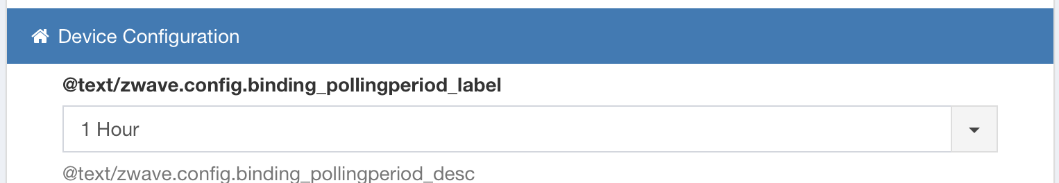

@vegarroe The two things you want to check in the configuration of those devices – the polling period and the wakeup interval. Those two parameters will determine the frequency with which you will receive updates from a device.
Edit: I should note that changes to the polling period will take effect immediately, because that is controlled by the binding. Changes to the wakeup interval will take effect the next time the device wakes up (as it is a message that is queued for transmission to the device).

From my testing it seems that the parameter that at the end defines when to get update for battery (and a status update for the switch) is the polling parameter, see screen shot. In addition the status of the switch of course are sent on change.
To get this working the parameter 111 has to be shorter than the polling parameter, e.g. 111 < 3600s for 1 hour polling. Mine is set to 111 = 720s.
