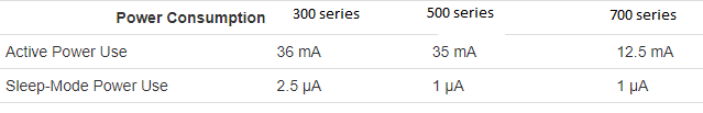

I think that the battery has a capacity of 1430 mAh, so at a constant current of 35mA, the battery should have a maximum lifespan of 41h. That was about the time I saw. I think you are right about that. The device must always or at least almost always be turned on.
