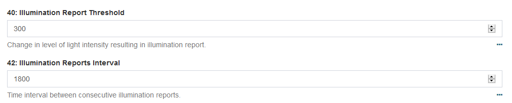

Zwave.
https://manuals.fibaro.com/motion-sensor/
The more frequent you send the lux values, the shorter is battery life, though.
I get about one year of battery life with the settings above.
