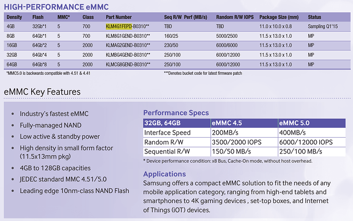

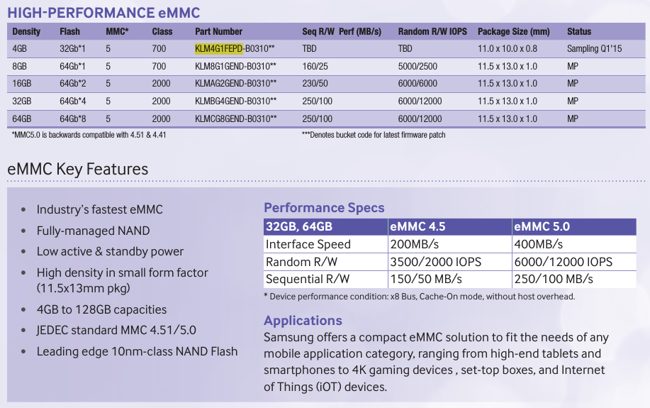

The RPi Compute Module used in the Telegea Smart Hub is designed for industrial use and mounts an eMMC flash storage which replaces the SD card. The flash chip is a Samsung KLM4G1FEPD. Here is some information from its datasheet.
We don’t have specific data for running OpenHAB on this device for an extended time but we’ve been using many of these devices for other projects for more than a year and never had any issue with the flash memory.
Raspbian with OpenHAB is running fine on the Telegea Smart Hub (see details here). We haven’t tried openHABian yet but if this is of interest we can certainly do this.
