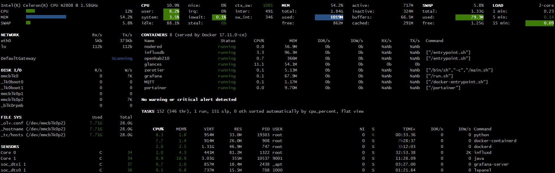

btw, I am currently running with 10+ items with influxdb and mapdb persist(cpuload1, storage left%, memory used%, humidity, temp, lux for every hour), and I also run docker glances to monitoring the system os health, it currently shows around 7k/s both write and read, does it looks normal in your perspective? (7k/s w/r, emmc) I did some googling but not sure why I always get 7k-14k/s(maybe it’s coming from ubuntu os log?)
and btw, I am using a x86 sbc with N2808+2G+32Gemmc, lubuntu desktop and running almost everything inside docker, so far I think this is the best hardware for OH2(low power=3w, low heat=33c tiny=100mm x 70mm)
I’ve no idea. Everyone’s system will be different and the amount of writes is driven by so many details specific to your setup that what is normal for me can and probably does not bear any resemblance to what is normal for you. I run everything on a desktop server in VMs so I’ve never bothered to measure.
I think the best will depend on each individual’s particular circumstances. For me the best is to run it on a powerful desktop server because I have so many other services I need to run (Claibre, Plex Media Server, Gogs, Alfresco, InfluxDB, Mosquitto, openHAB, a virtual desktop, OpenMediaVault, PFSense, ZoneMinder, etc). It is impossible to run all of that on a SBC, some won’t even run on SBC (e.g. Alfresco) by itself, and it is not cost effective to buy a bunch of SBCs to run it all. So for me that machine would be a poor choice.
