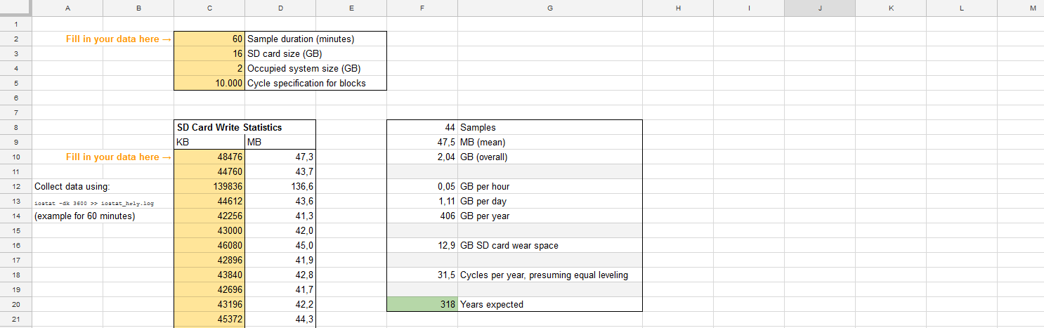

I did a few measurements a while back. Sampled the writes to the SD card on my production openHAB RPi for one week, projected the results up to a year and threw the result at the promised (SanDisk) write cycles of 10’000-100’000. Even when taking the lower end of this promise plus a small 16GB SD card as an example, the SD card will supposedly survive 318 years :boom:

For everyone who wants to reproduce the mentioned experiment: Here is the command to execute on your system that will generate hourly read/write statistics. Run it the command in a screen shell for a few days, then analyze the data collected.
iostat -dk 3600 >> iostat_hrly.log
Afterwards use the following table to generate your own statistics:
SD card wear calculation (Google Sheets)
