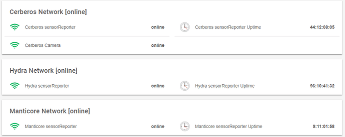

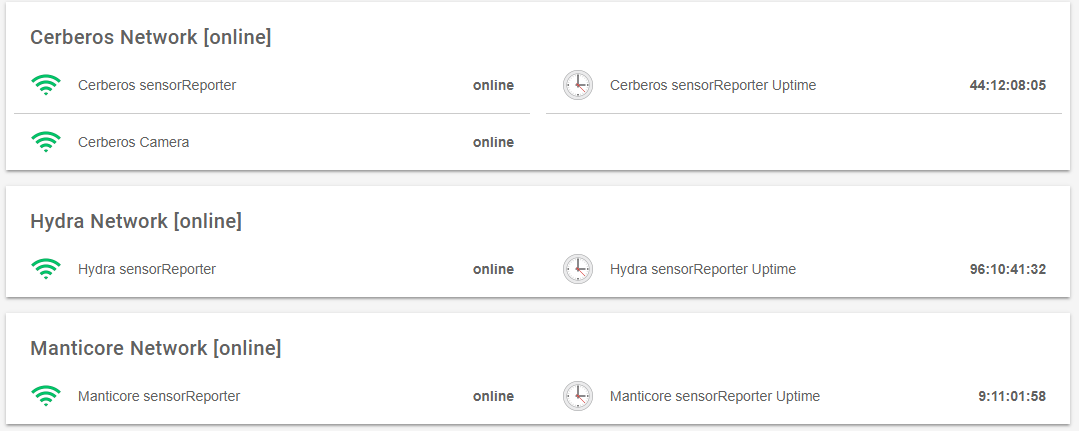

These are my running RPis. The uptime is reported in Days:Hours:Minutes:Seconds. So yes, Hydra has been running without problem for over 96 days without a reboot.
Cerberos is a RPi3, Hydra is a RPi Zero W, and Manticore is an RPi 1B. Note that the actual uptime is much longer. Those numbers are how long the service I have running on those Pis that report sensor readings have been running. I find them to be very solid platforms. I don’t think any of my VMs have as long of an uptime.
I’m not saying that your experience is wrong, but I don’t think it is the norm. Maybe you were unlucky and got a bad RPi.
I think the number of people who do so provides a decent counter-argument. I’m not trying to convince anyone that RPi is the way to go. In fact, if you have a choice I would recommend using a more powerful machine. But I do think it is well suited for the job for those who chose it.
I certainly can’t argue with those numbers @rlkoshak, very impressive! My issue with the cases was that by the time you add the cost of the case to the Pi you are close to the cost of a NUC, without having the SSD attaching via a USB cable, which just looked like a bit of a bodge to my eyes. The WD Pi Drive looked the best but was expensive.
