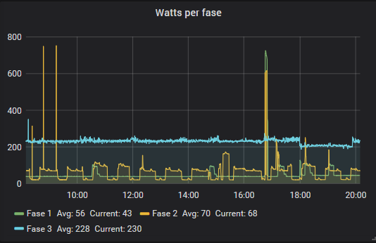

Store the data in a MYSQL database and make it visible with Grafana
It’s running on a Raspberry pi 3B, together with openhab. Both are running fine on the raspberry. Also with a P1 usb cable connected, which I bought on ali.
And one of the future idea’s is to use Grafana for more visualization, also because I do have solar panels. I installed a seperate modbus meter in the electricity box, but also didn’t found time to connect that one either. First a RPi4 I guess, since openhab and grafana on the RPI3 gave me issues with RAM.
