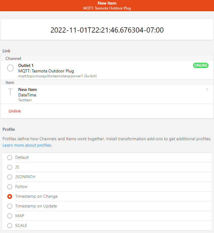

I just tried making a new item in the UI and connecting it to an MQTT device. The item immediately changed to the current date/time when I connected to an MQTT channel, and then changed again when I toggled the device. So if your item remains as NULL , then something’s not right.

I’m curious what will happen if you try making a new item and link it to a channel for a different device. I used an outlet, so that I could toggle it manually.
As noted previously, the item immediately updated from NULL to the current time as soon as I linked to the device channel with the “Timestamp on change” profile. I assume that’s because openhab registered the new channel link as a change.

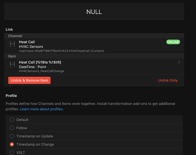

Here’s the item definition from the channel link view. I also tested with the semantic “Point” removed.

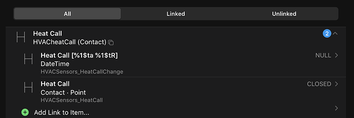

Both items linked to the channel. Heat Call changed from “OPEN” to “CLOSED” when I turned the thermostat up, with no corresponding update to HeatCallChange

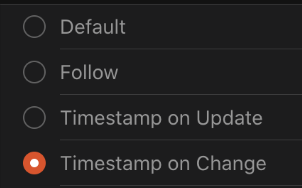

It’s strange that your profile options are out of order.
If you look at my screenshot above, they’re listed alphabetically. I don’t know why yours would be different.

I unlinked the item from the channel and found I could not re-link it, as the item picker only allows items of type “contact”, and there’s no way to specify the profile before picking the item (I also tried the same on a dimmer channel with similar results). I created a new item from the link GUI, selected the appropriate profile and set. my item type to DateTime, and it worked. I subsequently deleted the original item and recreated it so I could reuse the name, and it appears to be working. Thanks for helping me along this journey; now I can go back to debugging the CSS on my widget.
