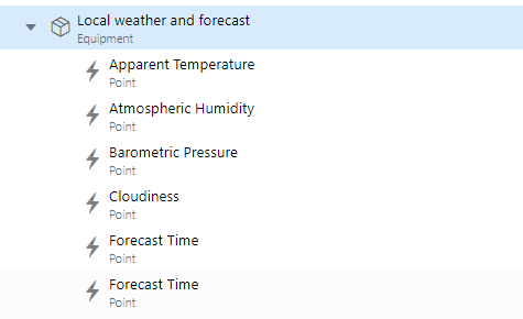

Next I went to Model / Create Equipment From Thing / Select ALL and create thing
You can get to this stage in a couple of min with every item created for you.

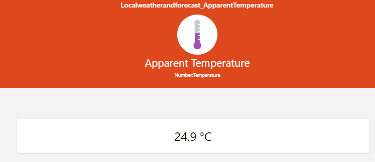

This Item Localweatherandforecast_ApparentTemperature Current outside temp
Is not the same needed for the widget Number localCurrentApparentTemperature "[%.0f°]"
You can’t change the item name once created in mainUI.

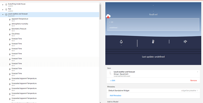

Creating items this way puts them all under a group.

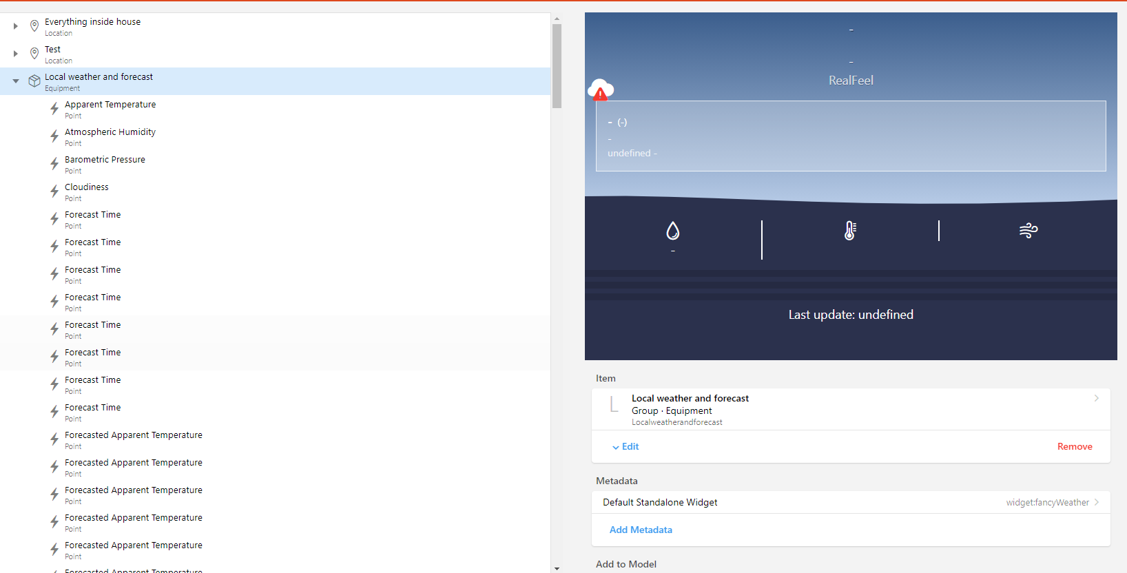

If you set a widget as the default widget the item props is auto populated to this value.

If the name: itemPrefix is changed to name: item then item would be Localweatherandforecast
Then you can assign each item using the auto generated item which will always have a Prefix
 =items[props.item + "_ApparentTemperature"].displayState || items[props.item + "_ApparentTemperature"].state

I think when selecting the Widget as the Default widget I can auto populate the data here.

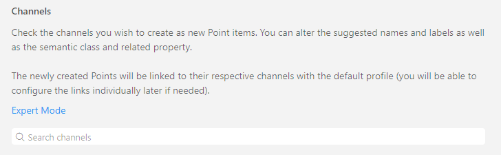

Wouldn’t it be possible to just use the ‘Expert mode’ in the ‘Create Equipment from Thing’, where you can just paste all the items following the pattern that comes with the widget? As I understand this - it would also link all items to their respective channels then?
What I definitely take with me here is, that I should take the full item configuration (with its ‘tags’, ‘groups’ and ‘icons’) into consideration and attach those to the widget I publish.

TBH I did not click on this until I read your post. To me this method is acceptable I just didn’t know about it. Sometime it needs to be right in my face to see it.
