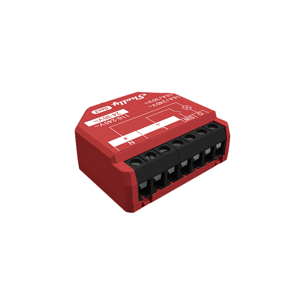

You might look at Shelly, they have some 16A products.

Not a plug in itself, but to be built in into a wall socket.
