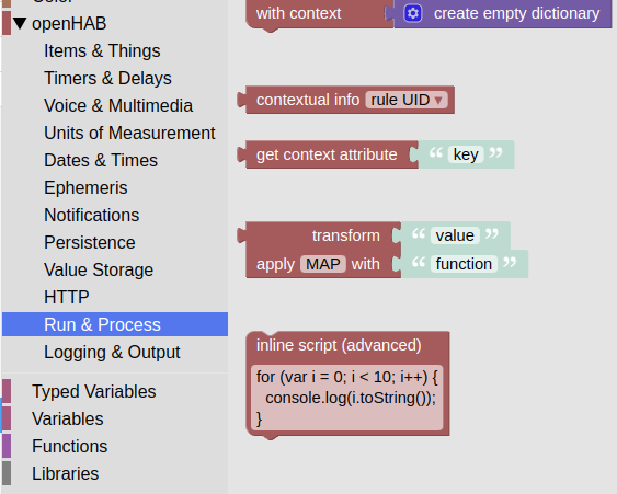

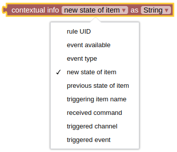

You are correct that the context variables are the way to go. You can find them again in the Run and Process group in the contextual info block’s dropdown menu:

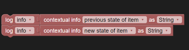

Thanks! Both new state and previous state are coming up as undefined. Do I have to get the context from somewhere?
When the rule was triggered by a Received command trigger, you will not get a previous state or new state data, because it’s irrelevant in this instance.
You will get received command data instead, because at the time of the trigger, that’s all the system knows and is telling you about.
Those previous state and new state context / data is available on a item changed state trigger event.
So one way to fix your script is to change your trigger from received command to changed as shown here:
If you want another rule when the state is updated (regardless of change), you’d use the was updated trigger. In this case, only new state is available. There’s no previous state context for an updated event.

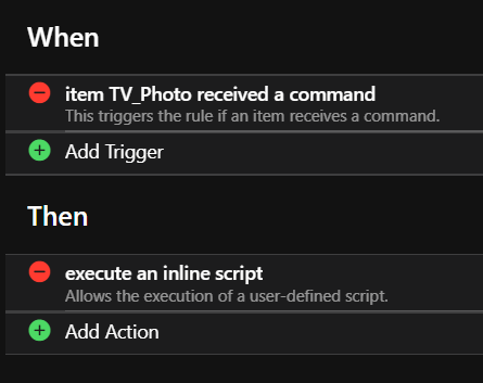

Sure! I’m keeping it simple right now.
The triggers:
And the “code”:
Thank you
Your trigger and your context information do not match.
Your trigger is “received a command” so the context information available is the command that has been received. If you want to have the state context information then you need one of the triggers that relates to an item state: “was updated” or “changed”.
