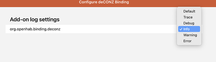

That being said, if you are on OH4, you should be able to simply switch on debug logging for the Deconz binding from MainUI. Go the the specific addon settings page for that. You should find it on the settings page.
You can also set the full binding to debug. That should be org.openhab.binding.deconz.
