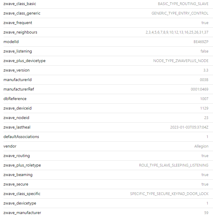

I have the same lock, and I also had apparent problems with the lock communicating events to the controller. Let me ask a few dumb questions first. (1) This is not the 700 series stick, right? Those aren’t compatible yet. (2) It was a secure inclusion? (3) Does it have lots of neighbors?
The thing is that now my locks seem to be behaving well lately, and I don’t know what changed or why. Over time I’ve changed my setup. I’m using an Aeotec Z-stick Gen5 now. Here are the properties from my Lock thing:

  3. It reports 11 neighbors
Here are my properties:

You did include it securely, so that’s not the problem.
  1. Yes, it is the 700-series. Is that incompatibility from OH or the lock (Schlage, definitely - they had never heard of Zooz)?
Ah, the 700 series. Believe it or not, I also used that stick for a while at the beginning and it was mostly compatible, but Imy zwave network was flaky at times. I then found out that the OpenHAB z-wave binding is not fully compatible with the 700 series. This may be part of the problem. I’d recommend getting a 500 series zwave stick and seeing if that improves things.
