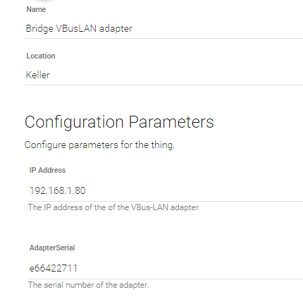

I created the bridge as Thing in Paper UI:
After that the item and corresponding channels arose automatically (if I remember correctly).

Exactly this is how I also did it. In Paper UI created the bridge and afterwards the things are automatically detected and you can add them from the inbox and link channels to it. It should also be possible to create the bridge and other things manually in the item files, but I do not have much experience with that and documenting that will be one of the challenges for making the binding mergable into upstream…
