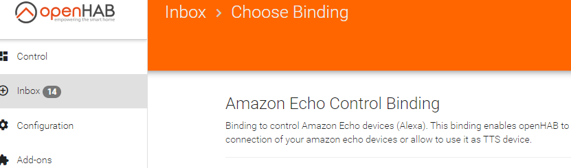

Can I discover in OH items that connected to the echo? (such as sonoff, Yeelight…)
According to the doc attached it is possible but when running the binding - nothing discovered:
Not using the binding version included. Thats why i linked you to the preview/beta release.
You need to remove the current binding in paperui. download the jar in the link above, and put in your addons folder.
So you are saying that version 2.5.0 has this ability and 2.5.1 doesnt?
I put the jar file in the addons folder - how do I see it on the binding screen ? (it’s still show me the 2.5.1 version)
I am saying that the version i linked you too is a pre-release version of the binding. ignore what it is suffixed with as this is just what version it was compiled for.
remove existing version. restart openhab and clear the cache. drop the new jar in your addons folder.
i believe then you can just run discovery and it discovers echo devices (check the post above though).

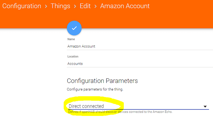

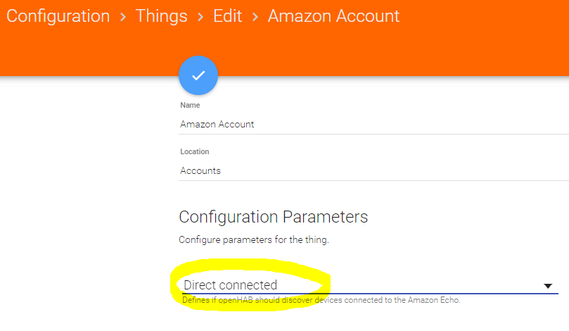

I manage to install the amazon binding with the pre-release version.
I am trying to add smart home devices.
When trying to set in the amazon account “discover” I am getting error 409:
Actually, any action on the amazon account get this error (this thing was defined before replacing the amazon binding version)
The clear cache doesn’t solve that either.
Any suggestions on what could I do?
Have you removed your existing ‘account thing’?
Normally a conflict is when there is something by the same name
I can’t.
Getting the same error.
