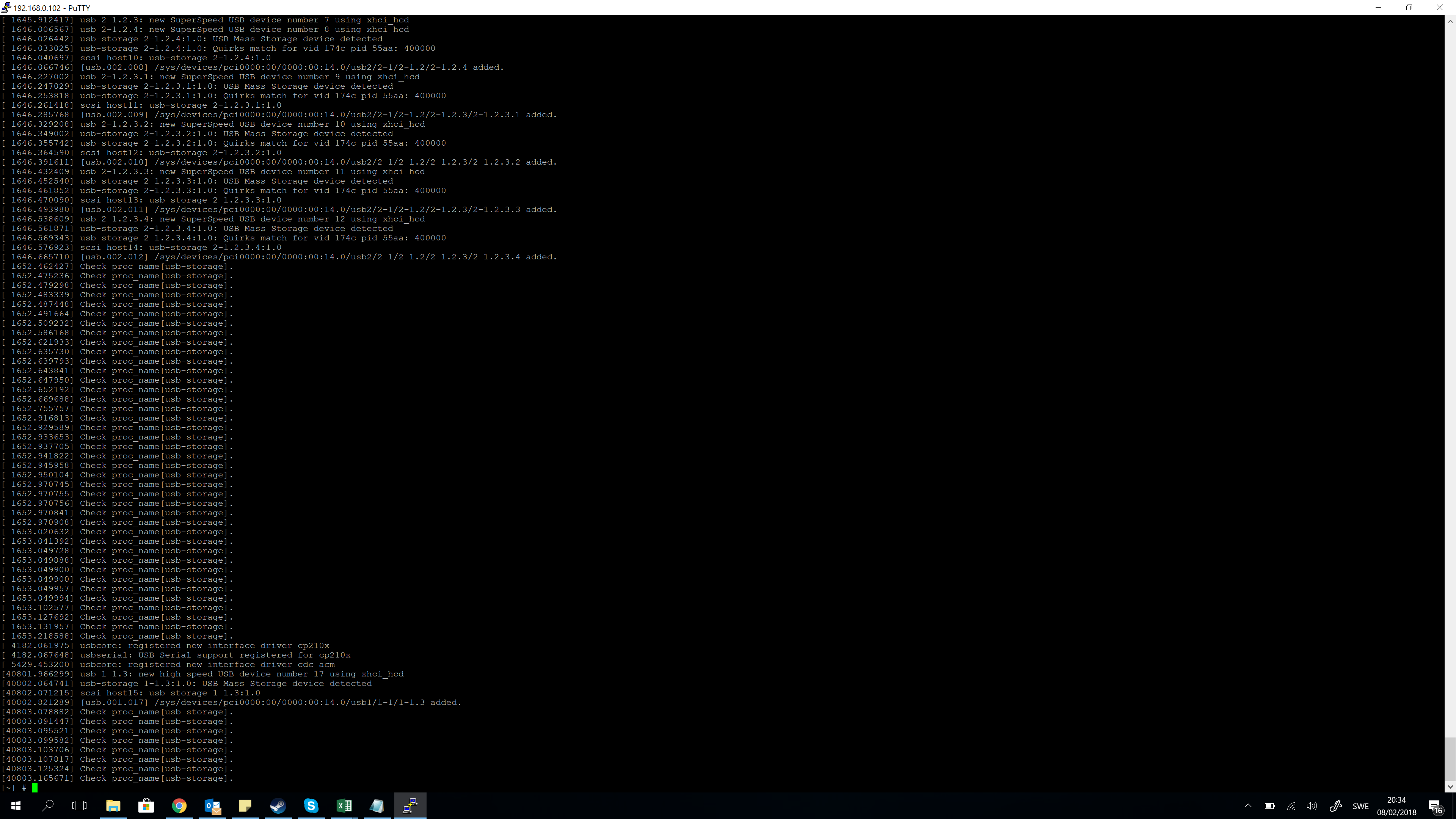

I’ve gone trough SSH and done what you can see in the image below.
I’ve done the “insmod /usr/local/modules/cdc-acm.ko” successfully before just did it an extra time for the screenshot.

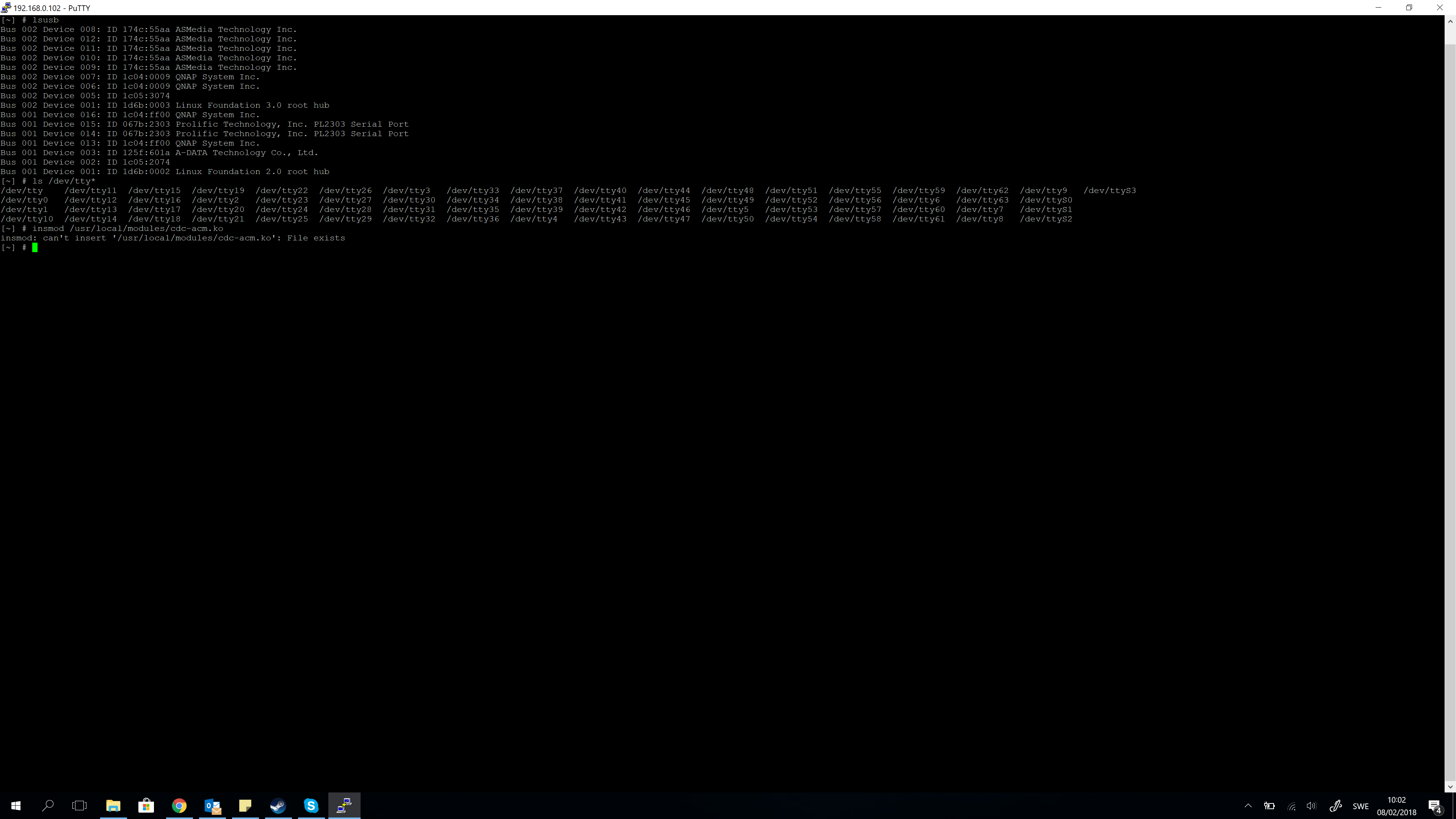

I see in your lsusb you are missing the following
Bus 001 Device 004: ID 0658:0200 Sigma Designs, Inc.
I would suggest unplugging and plugging back in to see if it shows up in lsusb or look through dmesg to see if there is any indication there why it didn’t load the hardware. Hopefully Qnap has a dmesg file, I don’t have the hardware in my setup so I’m guessing. :confused:

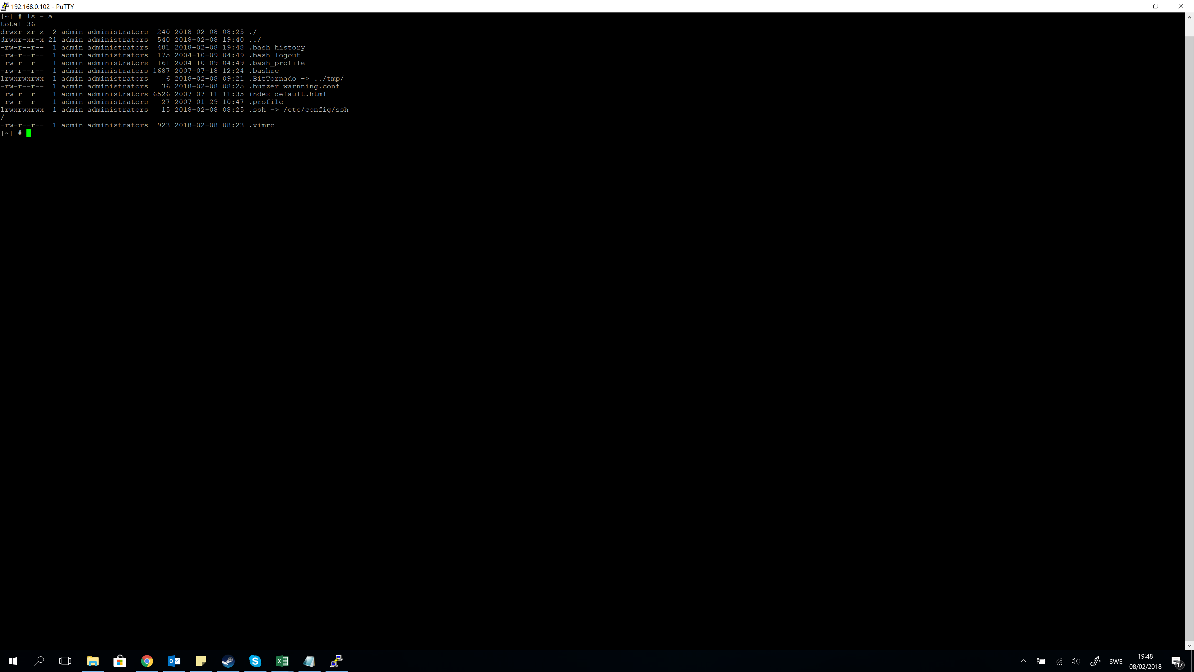

Do a listing of ls -la and look for a group of dialout.
Yes, I am using a NAS (Qnap TS-253 pro)
USB drives are seen without any problems. I can’t see the z-wave stick and as I understand it I can’t see it trough SSH either.
I have checked that the USB works on my PC.
Maybe I should just fire up my Raspberry…
List of what? group of what? Sorry I’m pretty new at this…
Sorry, a listing of…
ls -la /dev/*
https://forum.qnap.com/viewtopic.php?t=131048
I’ve tried what it says in that forum thread. didn’t work. Got allot of text doing that command. anything in particular that I shall look for?=P

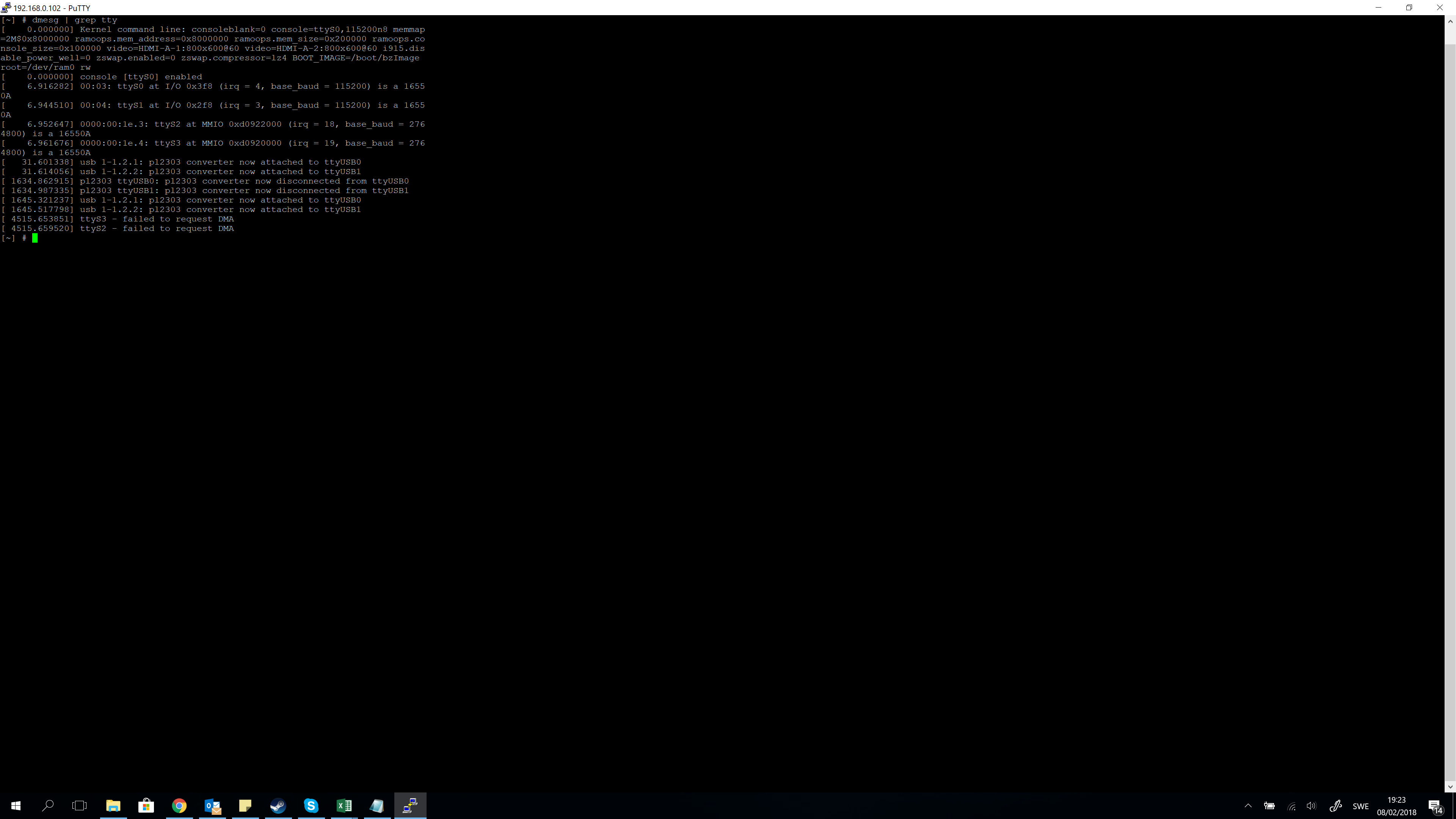

Also you did a dmesg | grep tty, instead try a dmesg | grep usb after you plug it in

Saw this when I used that command:
In the end it says it has registred new usb driver “cdc-acm”
Did as you said used “modprobe” and after that I could see cdc-acm. After reboot it was gone again.
But now I see ttyUSB0 and ttyUSB1 when I do the “lsusb” command.
