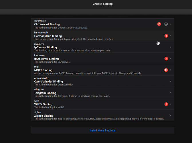

I would not want Alexa to have access without my express knowledge and others have this same view, so it is best to take the “OPT IN” approach, where if a user wants this feature, they have to turn it on. Does your binding setup a BRIDGE thing that all things connect through? If no it is also possible to set configuration at a binding level where a user can flick a switch from the default NO, to say YES (true) “auto add Alexa tags when discovery is done”. To access this configuration on an unmerged binding in the addons folder, you need to go to the INBOX, press the PLUS + icon and in the list of bindings, you press the gear icon. See how only the Chromecast binding has this gear icon.
