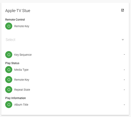

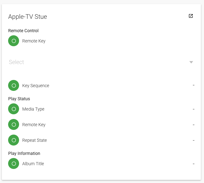

Now, Paper UI looks like this (No data - not sure if they are supposed to be there?):

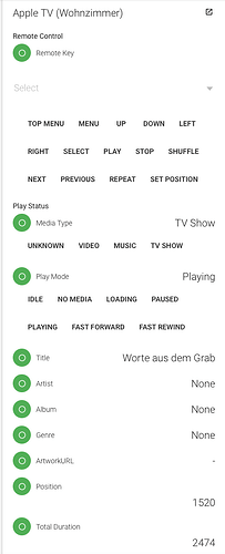

For now the alpha release is able to send keys. The status information and events are not yet implemented. I already add the channel definitions, but “run out of spare time” at that point. It’s on the list, but I’m pretty busy at the moment. A list of valid keys is included in the README.

More progress, I’m getting the status information - like event, but I need to poll them.

  • Automatic device discovery (background and from the Inbox)
  • Support for multiple Apple TVs (needs verification)
  • Periodic play status updates
  • Set position, shuffle and repeat mode
  • Relative positions (+10, -10, -30:00 etc.)

Could someone please check if installed on 2.4 you still have the item in Paper UI’s Control section? Works fine with my 2.5 dev setup, but doesn’t shows up on my 2.4 prod setup.
Important: Existing things have to be deleted. You should shutdown openHAB before updating the jar, maybe you need to clear the cache.

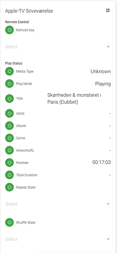

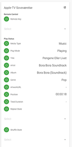

I was able get it set up on my gen 3 ATV. I was able to get artist and song information while playing some music. It doesn’t automatically fetch the album art, but I think that might be in a future release.

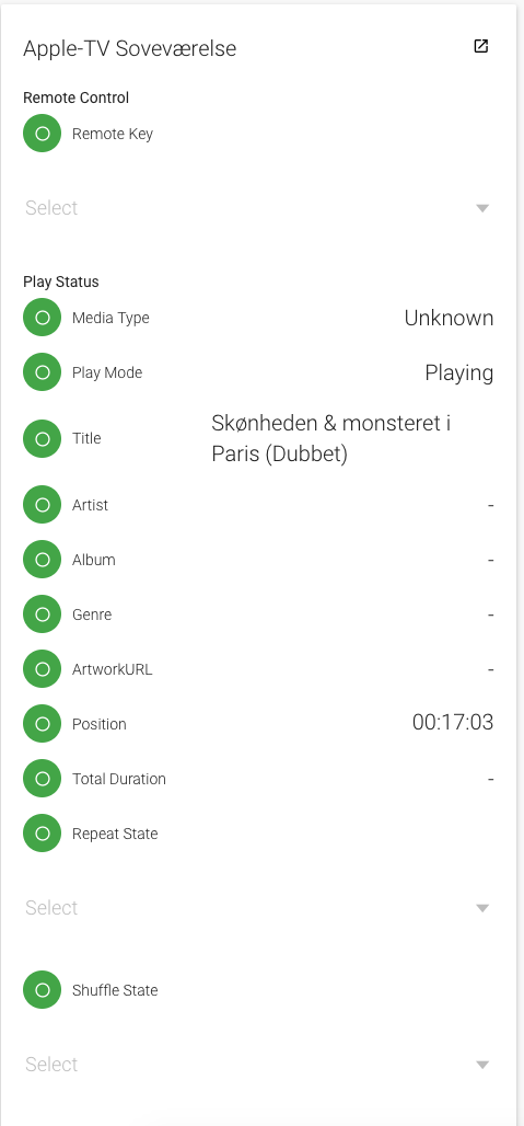

I have the 2.5 binding on OH2.4 - works ok it seems (have only glanced). I see some play info:
Apple TV 4
yes, album art is on the list. However the ay pyATV works is
