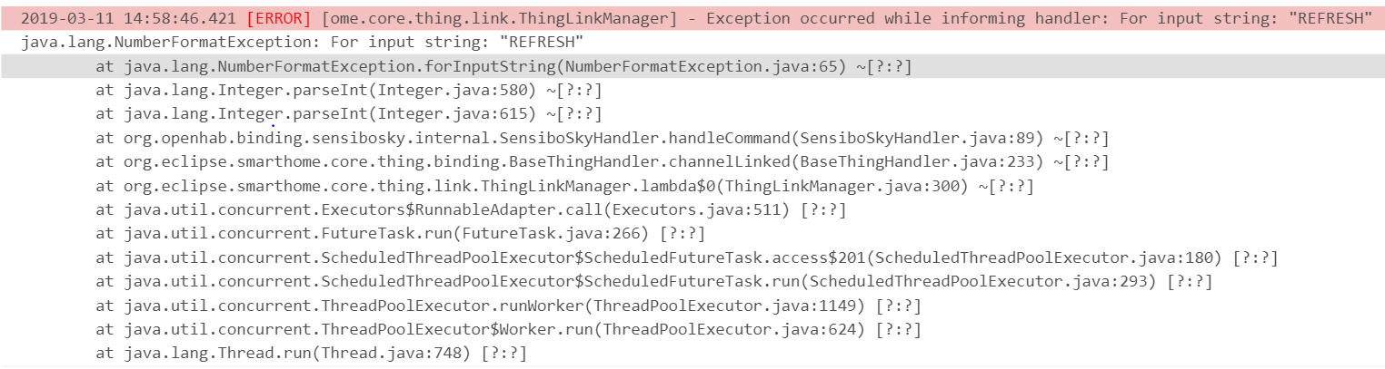

How do I read the status of and initialize the different channels?
Current_temperature and Humidity works but the other channels are not initialized unless I change them from PaperUI or BasicUI.
If I use https://home.sensibo.com/api/v2/pods/{device_id}?fields=acState&apiKey={api_key} status is returned correct.
I use OpenHABian on a Pi and when I start OpenHAB I have the following in my log:
Yes currently only the temperature and humidity is being synchronized. I’ll add the rest as soon as I can solve my current problem. I’ll check the exception then too.
