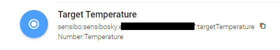

The item type for target temperatue is Number:Temperature
      "linkedItems": [
        "AC_lounge_Room_Target_Temperature"
      "uid": "sensibo:sensibosky:home:lounge:targetTemperature",
      "id": "targetTemperature",
      "channelTypeUID": "sensibo:targetTemperaturelounge",
      "itemType": "Number:Temperature",
      "kind": "STATE",
      "defaultTags": [],
      "properties": {},
      "configuration": {}

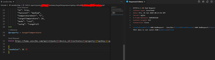

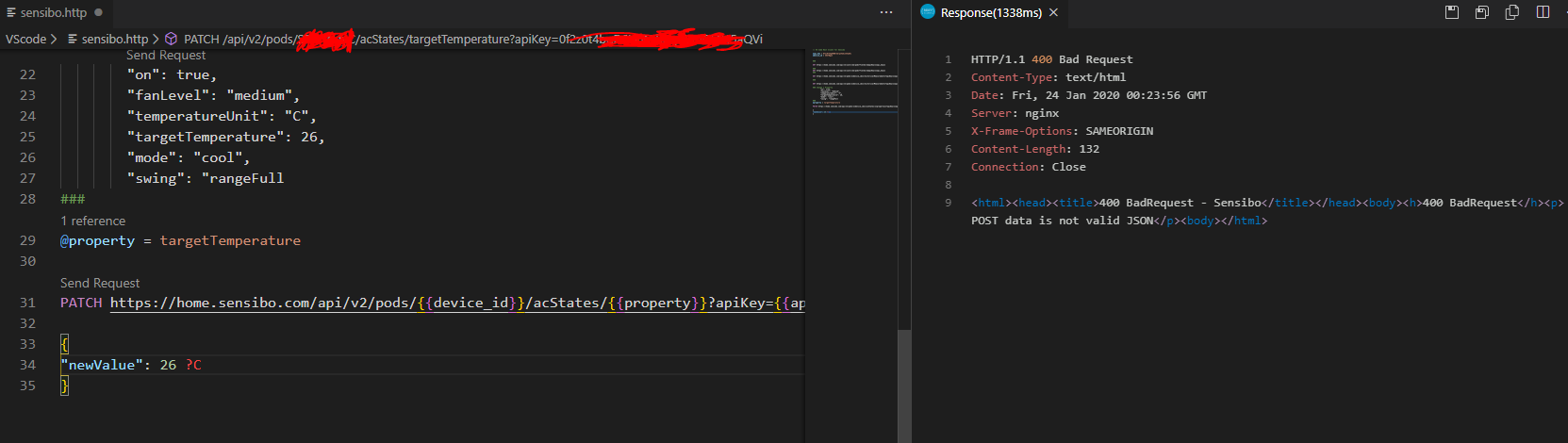

If I try and PATCH sensibo with the value 26 ?C
The error is
If the binding is just posting all the data to the sensibo api all the time you will just get this error.
