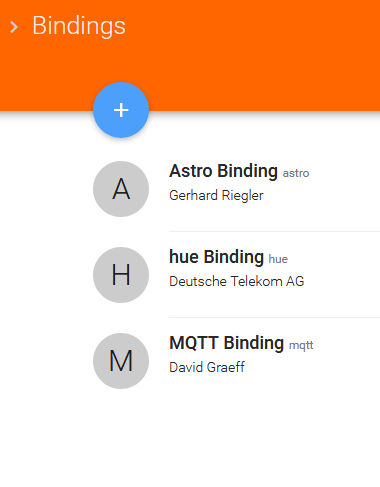

I am trying to install the Weather Binding in paper and it does not install, was spinning for at least 20 min, any suggestions. When I select say a thing and then goe back to bindings it says it’s installed but does not show as a binding so it looks like it did not install.
After closing when it still says its installing
Binding section (not there)

@waketech v1 bindings sometimes do not show in PaperUI. You can use the console to check/verify if it’s installed. From console bundle:list to see everything that’s installed.
Use sudo openhab-cli console for console access.
