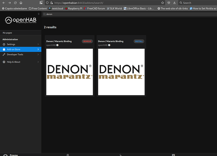

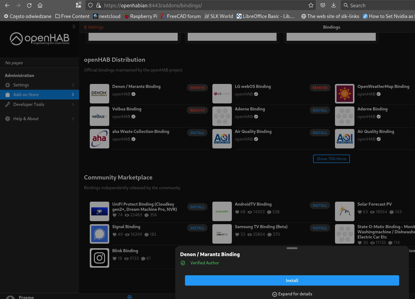

openhabian installed in the last few weeks. Settings migrated from another installation (that could be the source of the problem, I developed code changes to denonmarantz)
The console looks OK:
openhab> la -s | grep -i denon
246 │ Active │ 80 │ 4.1.0 │ org.openhab.binding.denonmarantz
But it’s installed and uninstalled in the same time.
How to fix it? Where is the info stored?
I’m OK with ant type of fix, down to manual mods of databases using SQL, if needed.

If you have a jar add-on inside the add-ons folder, you’ll see two entries in the add-on Store. One for the stock add-on, the other one for the jar.
