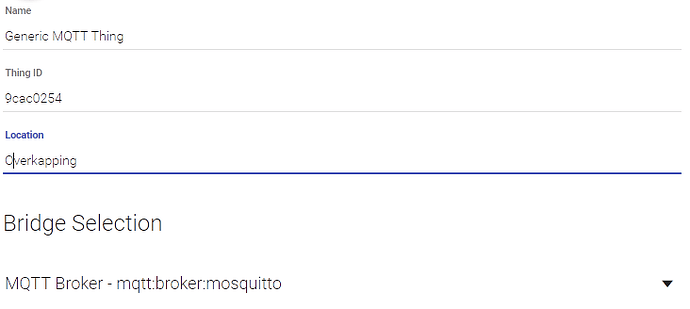

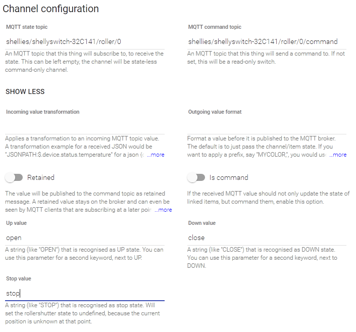

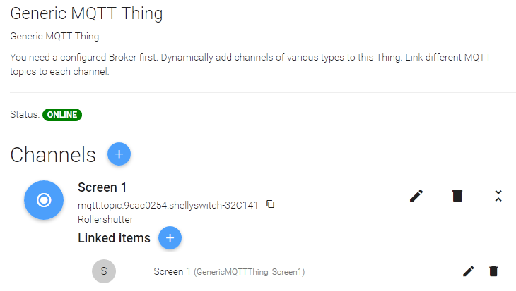

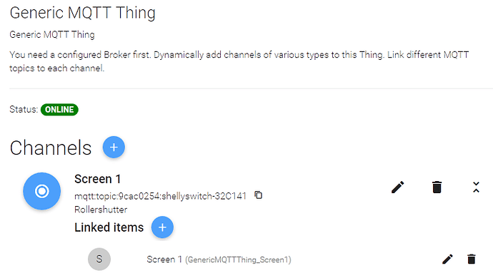

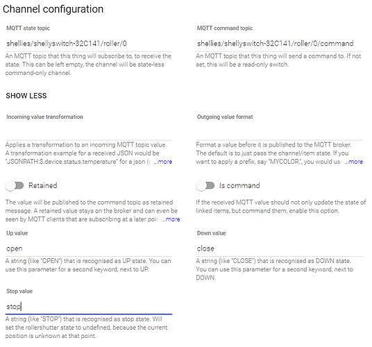

Hello Guys,
I am using the Shellyswitch2 for handling a rollershutter.
My setup is:
Openhab2 latest snapshot with binding-mqtt - 2.5.0.SNAPSHOT
Mosquitto broker
Mosquitto clients
I added the Thing in paperUI
created a Channel in paperUI
and linked an Item in paperUI
In control I see the controls for the rollershutter
Now for the issue I don’t understand…
When I push a control-button it publishes:
0 instead of stop
0 instead of up
100 instead of down
on the mqtt-broker and the ShellySwitch2 does not react.
I filled in the correct pay-load and toppic…I think.
Can annyone help me?
A rollershutter is a percentage value for openHAB internally. Put aside that stop was wrongly implemented by me and a fix is on the way (after everybody returned from holidays), UP and DOWN will send the target percentage. This might not be clear from the docu (create an Issue if so).
If your shelly wants “stop”, “up” and “down” you should define a switch with those three commands instead. (Can only be done textual on item level unfortunately)
