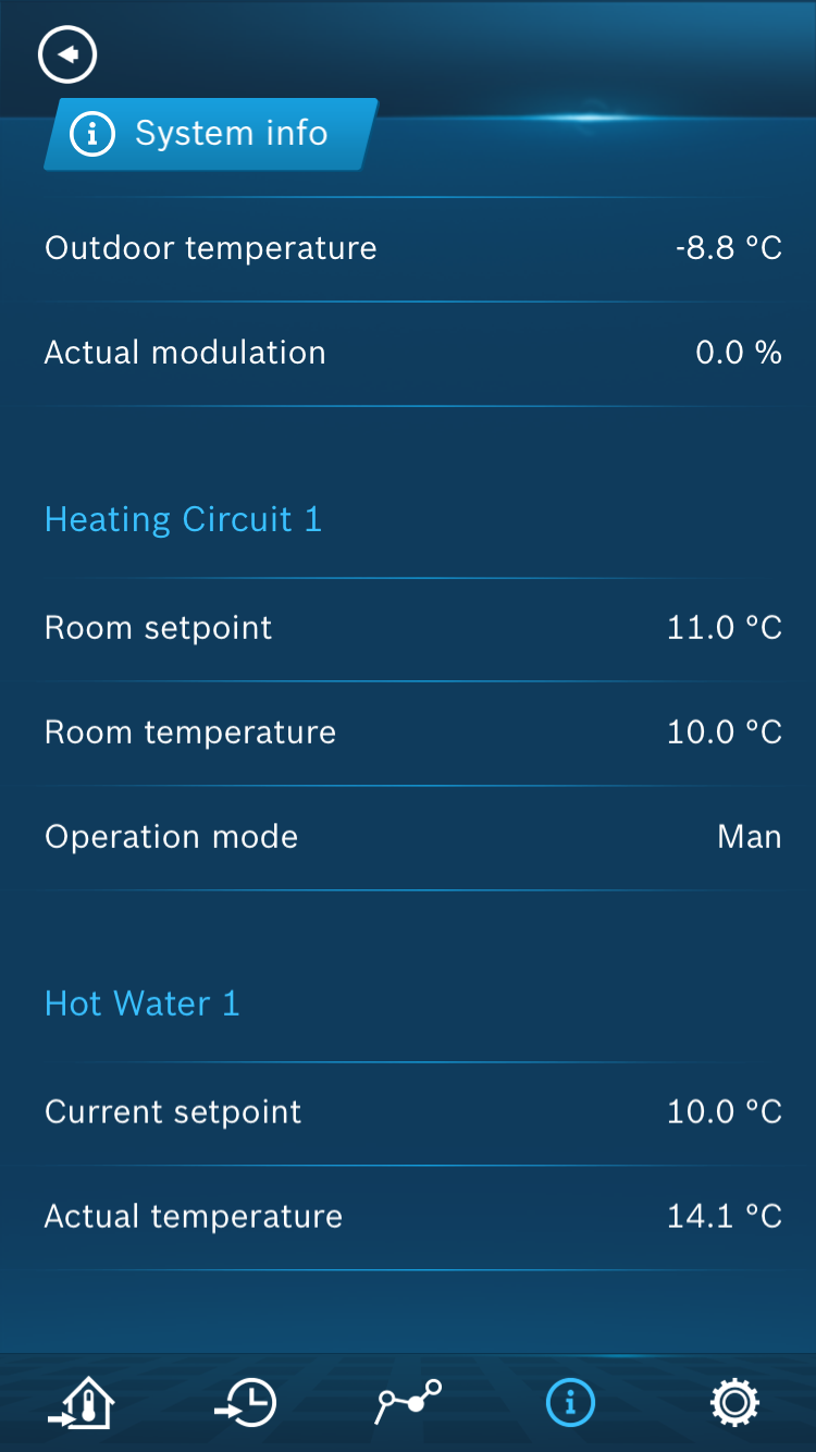

Do you have in the EasyControl app a “HeatingCircuit 1” ? (Press “I” and then “SystemInfo” or in History/Switching Points)
Thanks, and yes, I will port it to OH2. But it will take some time…weeks..
I have “Heating Circle 1”.

Are the values where e.g. chimney temperature is negive comming from the gateway or is there an issue with the binding?
Are such figures alsocomming from the gateway or a conversion issue?
2017-01-17 18:53:45.262 [ItemStateChangedEvent     ] - HeatingOutsideTemp changed from -5.30000019073486328125 to -5.599999904632568359375
