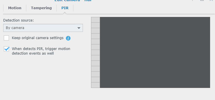

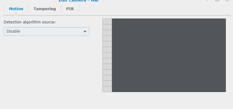

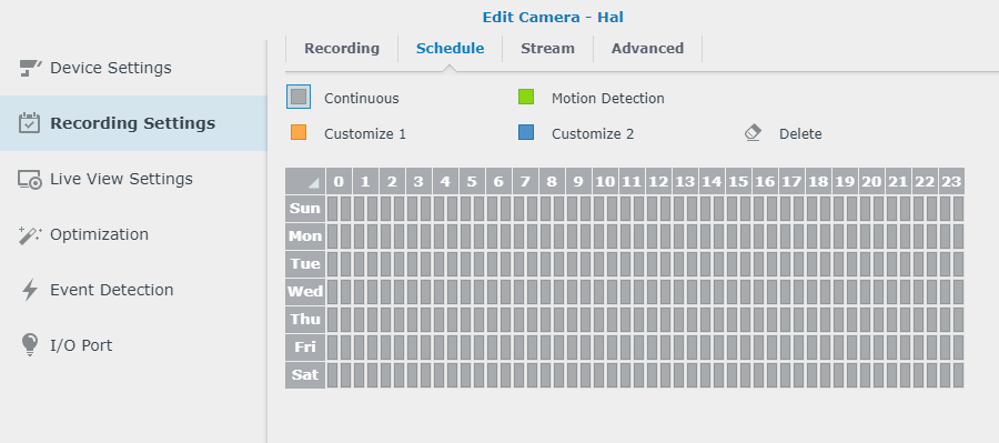

My settings are the following in surveillance station
I still can’t quite reproduce your issue but I sure can add another reason (1) if you think it works (i.e. fires properly at the right time) and are willing to test it.
