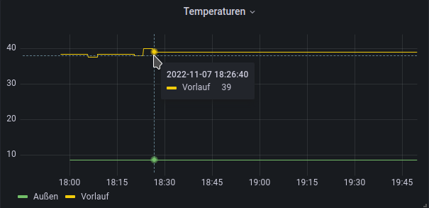

Hi @rogrun,
unfortunately, the binding seems to loose connection after some kind of communication error. As I looked on my values today, I had to see, that no values where updated. I got the last update yesterday at 18:26:40.
In the log I’ve found the following lines:

After restart of the binding everthing is working fine again.
openhab> bundle:restart 286
I have installed your last snapshot version.
Do you have any idea what’s going on?
Thanks! Martin
