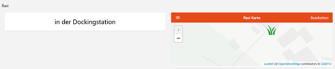

If it’s only about displaying stuff, i have just built a solution for basic usage, based on this GitHub Code.
Currently looks like this:
I’m pretty sure i can also control it that way, but didn’t implement it by now. The actual data is collected by a python script:
