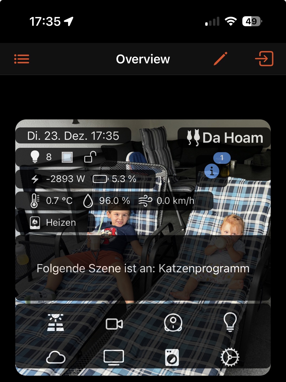

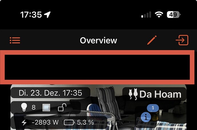

Black bar at top of screen on iPhone 17 after update to iOS App 3.1
Since the last openHAB iOS app update (installed a few days ago), a black bar appears at the top of the screen on my iPhone 17.
This black area was not present before the update and reduces the usable screen space.
I have attached a screenshot showing the issue.
Is this a known problem and is there a solution for it?

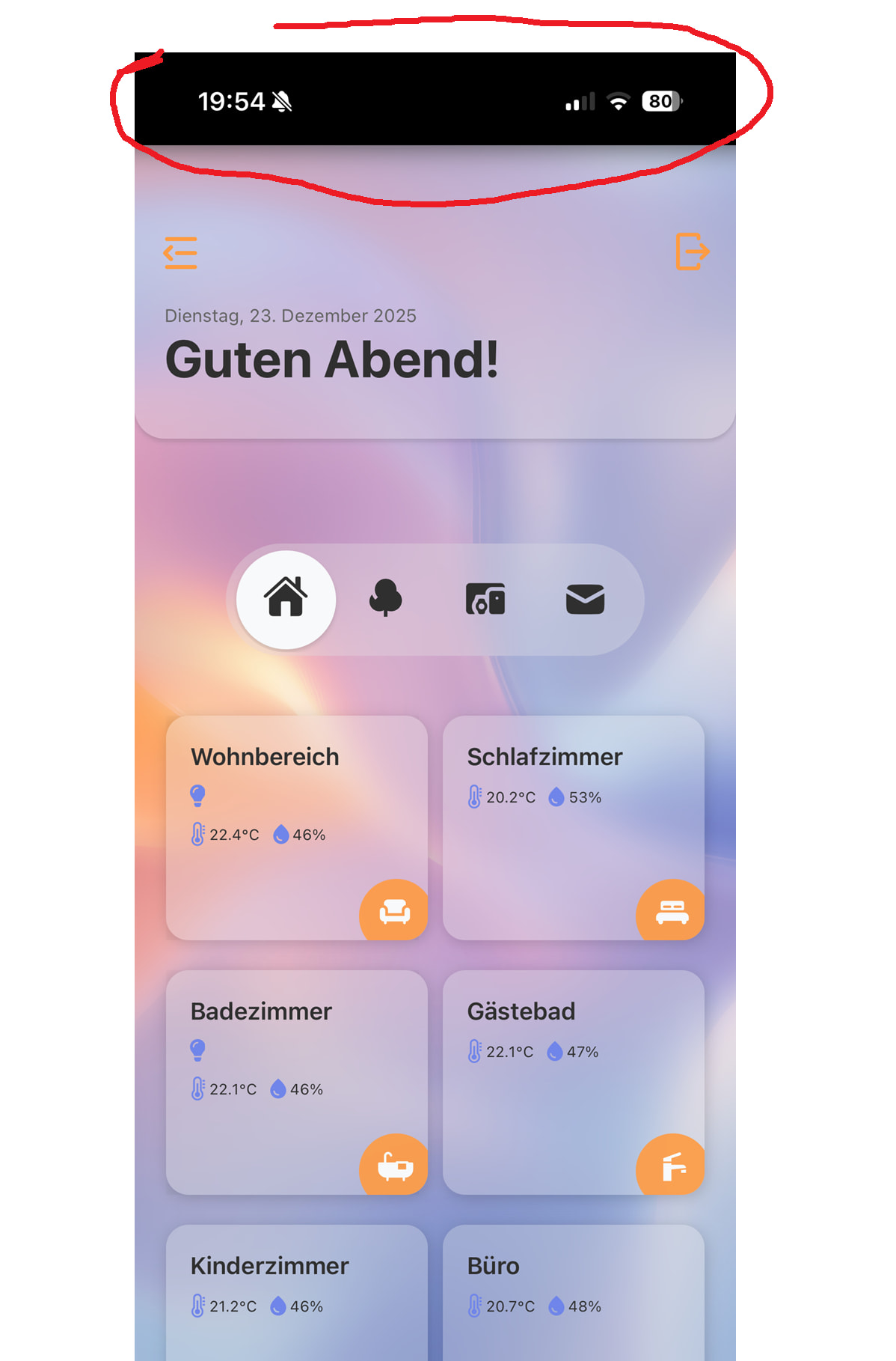

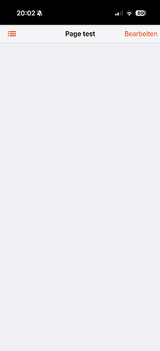

Not sure i understand actually, @BastianR i see the iOS status bar, is this what you are talking about ? I’m looking at an older version of the app (v1) and the only difference i am seeing is it seems like the bounds are the same, but we would render the overflow under the menu bar, which now that i look at it i think should be added back in (its a nice effect). Just want to be clear what the problem is.

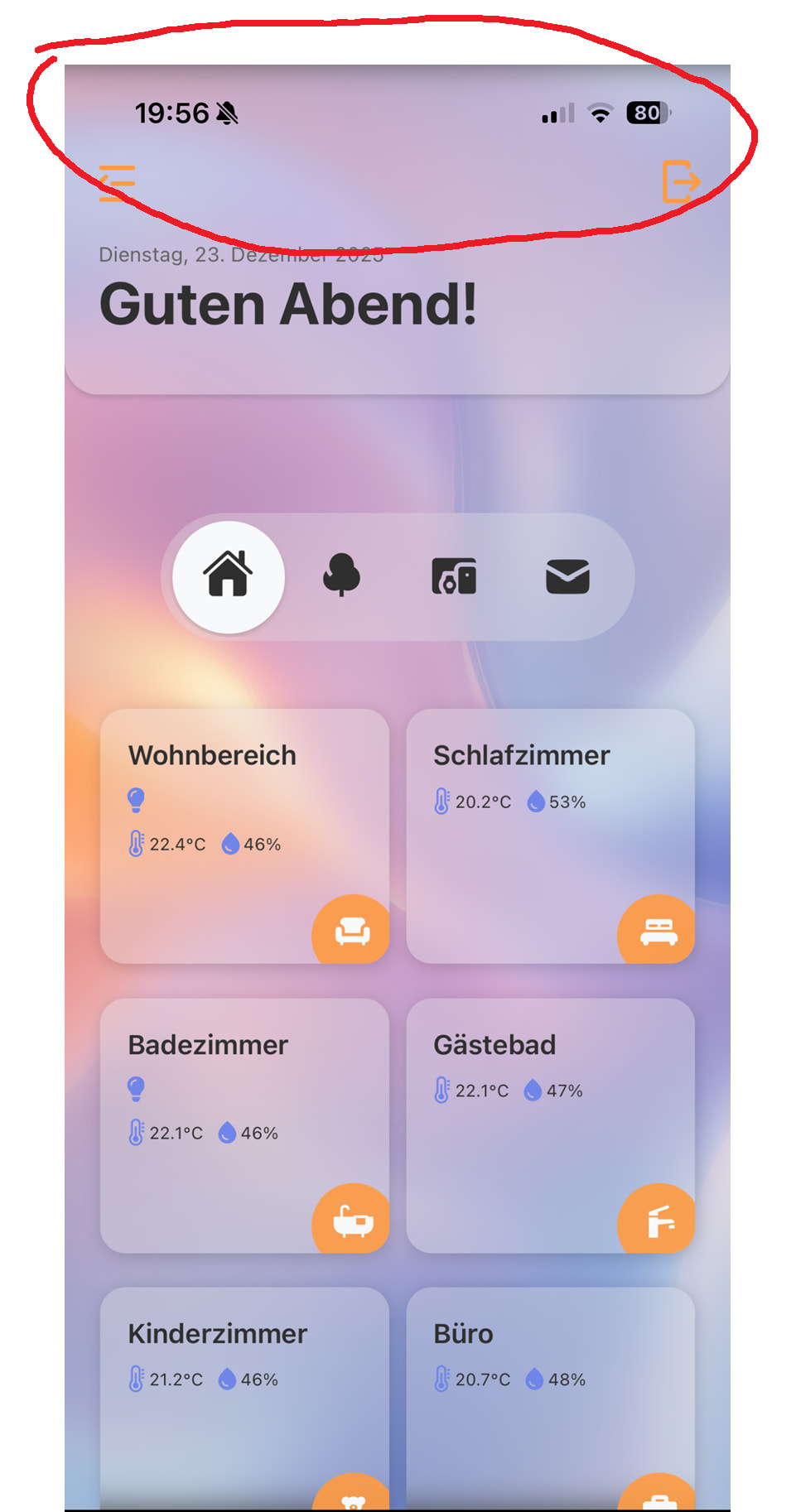

I cant speak for @BastianR but in my case I am talking about this gap
Please try this in Safari (ios / desktop), my guess is its the same behavior? In which case its an issue with the MainUI and will need to be fixed there.

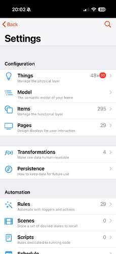

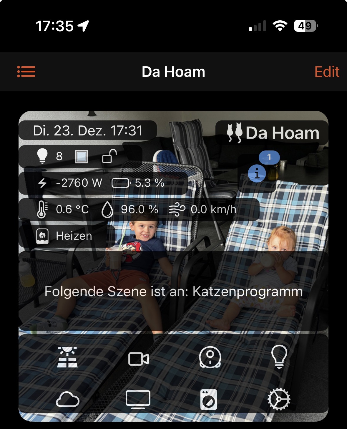

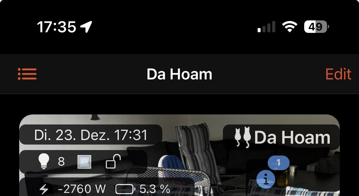

@digitaldan You’re right. I’m talking about the IOS status bar. When I activate the light-theme it is a little bit more clearly, what i mean:
I also took a look into the old version of the app (v1) and here we can see the difference:

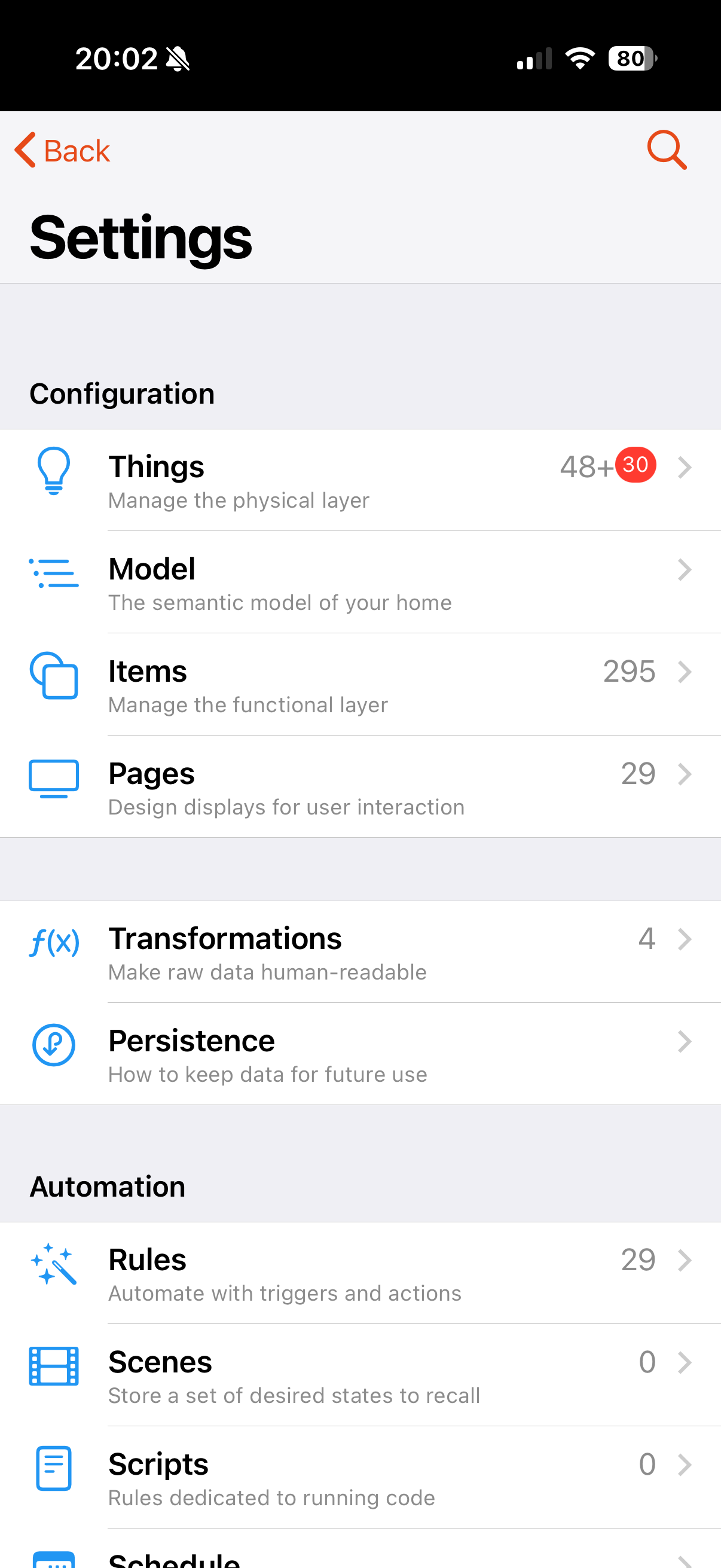

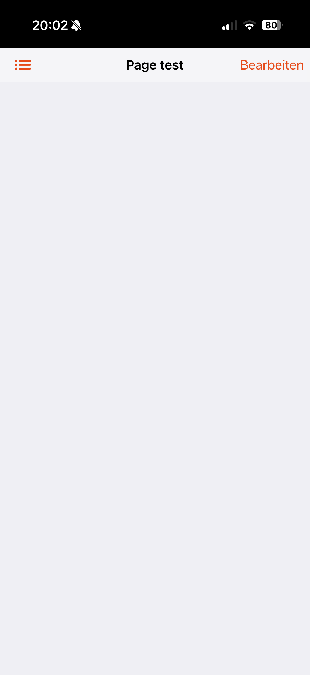

I should also mention that this behavior doesn’t only occur on the Overview, but on all other pages as well.
Below are few examples:
In Safari it is the same behavior. Therefore, I think you are correct in your assumption that it is a issue with the main UI.

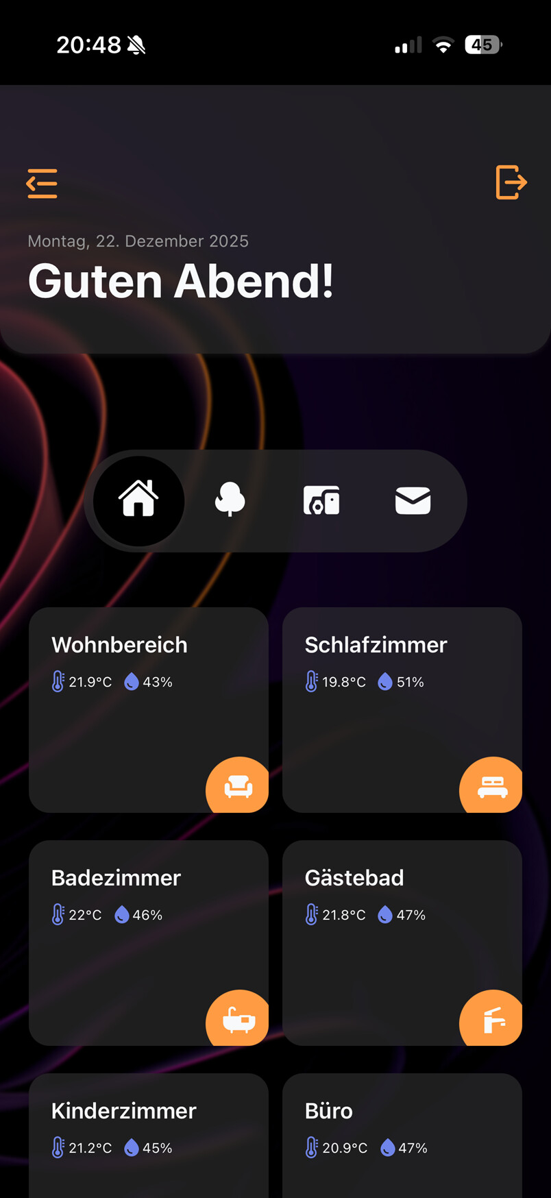

@mvbergen Thank you for your compliment! :slight_smile: It took me a lot of time to design the UI like this.
This page in the screenshot is not the original overview-page. It’s a normal layout page, which I’ve designed like the overview-page with my own features.
You can let the background image reach the top of the screen, if you add below CSS styles in the code section of your page:
    height: 100vh
    top: -16px
    width: 100vw
The icons are all from iconify: https://icon-sets.iconify.design/
The cells are independent widgets. There you can move the position of the icons or other element with the css styles “margin-right” and “margin-right”.
