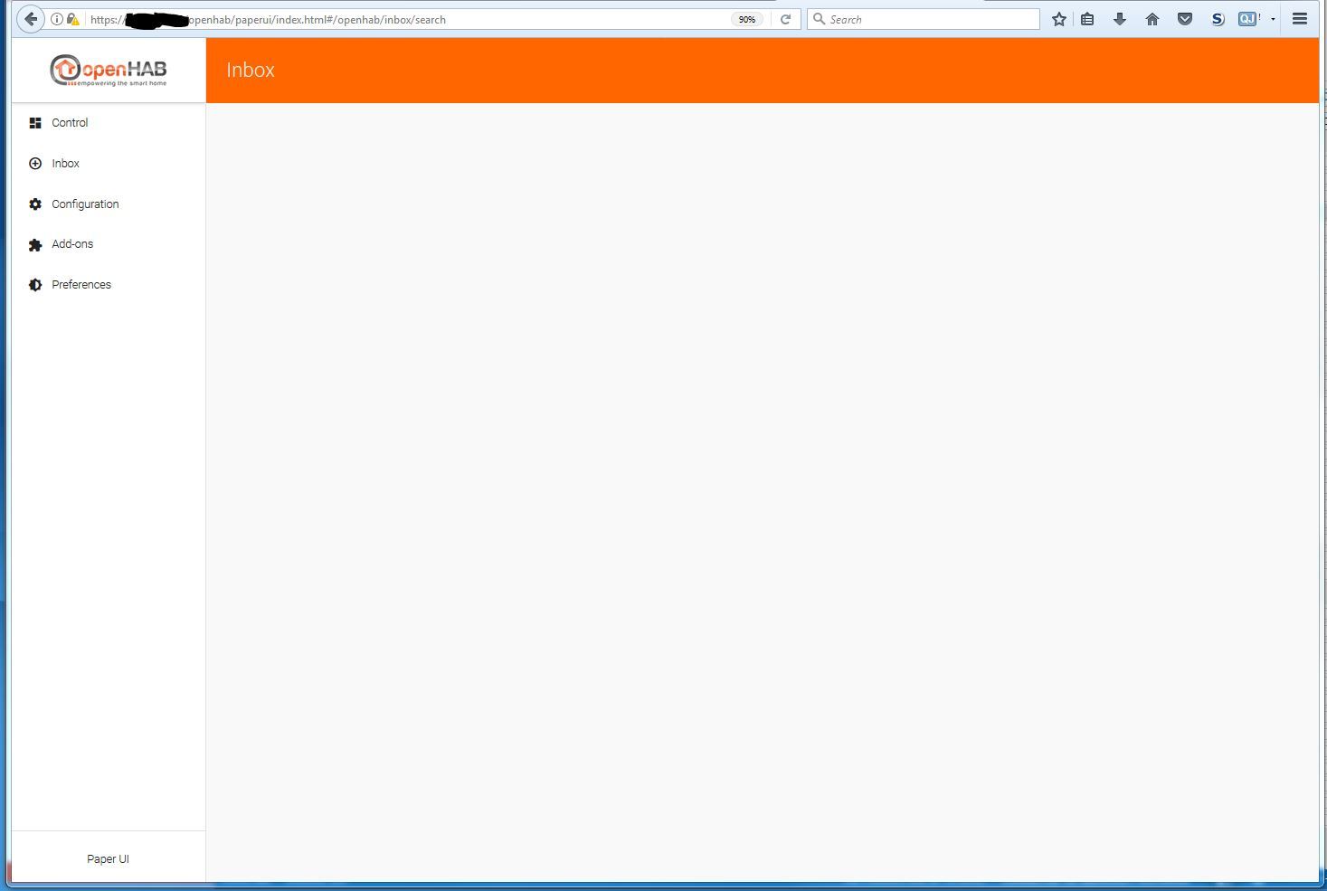

Ubuntu 16.04, Openhab new install. Have installed 2 bindings, network and zwave. Using PaperUI, but the “inbox” is blank. Control, Inbox, Configuration, Add-ons and Preferences is down lefthand side, and there is an orange bar across the main frame that has “inbox” in it, but the rest of the browser display is simply blank. The tutorials indicate I should have some “search” and “add” functionality on there. I can find no errors in the logs.

I can’t tell from your description exactly what you are seeing.
When you go to configuration do you find entries there? Do you find your installed bindings in the services submenu of configuration? If you go back to addons and browse to the ones you think are installed, do they actually show as being installed? Are there errors in your logs?

This is not the “standard” one… (http://<IP>:8080/paperui/index.html#/inbox/search)
Press F12 in your Firefox browser to bring up the debug console to see what might be wrong and try to fix (if possible) your Apache reverse proxy configs.

[quote=“Dim, post:9, topic:28412, full:true”]This is not the “standard” one… (http://<IP>:8080/paperui/index.html#/inbox/search)
[/quote]
This means I have something wankered in my rewrite rules?
RewriteEngine On
RewriteRule "/openhab/openhab/(.*)" "/openhab/$1" [R,L]
RewriteRule "/openhab/?(.*)" "http://localhost:8080/$1" [P,L]
I must admit to being lost in what these rules are doing, but from your post I would think that I have an extra “/openhab” in all of the lines, but it wont seem to work without it.
A guess here…the path in the CSS is looking for /js/variousstuff.js and this doesnt seem to be in the rewrite rules, so, for example, in the paperui inbox, the /js/search.filters.js is not being found by the browser, is this my problem?
I (who wrote the “Apache 2 reverse-proxy…” tutorial) never used the “Inbox”, so far (my configuration is completely manual). I assume that the “Inbox” uses other paths that are not yet rewritten to contain the “openhab/”-path-prefix. Hence, the problem is very likely not that substitute-rules are wrong, but that substitute-rules are missing.
As already stated in my tutorial: It totally sucks that OH does not support a path-prefix. Thus, all paths of the various OH-components need to be rewritten individually – which is easily incomplete.
Unfortunately, I can’t check this “Inbox” right now, because I’m on a 2 month business trip. I’m going to take a look at it, when I come back.
And @OH-team: You really should add a path-prefix! Even a hard-coded path-prefix would be better than none, because rewriting e.g. */openhab/* would be far easier than rewriting dozens of individual paths!
