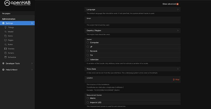

The app works after a fresh installation and when I setup the remote connection but after a while when I open again, it shows me a blank screen like you see in the screenshot.
Does anyone have the same issue or how can I fix this ? Is this probably a bug because I have the new Android 14 and maybe it’s not yet compatible ?

I just tested it and I’m seeing the same behavior, Pixel 6 Pro running Android 14. Because I’ve seen this before I can’t say if it’s related to Android 14 or not.
I’ve had this happen a couple of times, I don’t think its related to an Android version I think something is stuck with trying to display. WiFi works, force kill the app, turn off WiFi verified mobile data is operational, open OpenHAB app…blank page.
What is bizarre is the Android Device Controls buttons still work and can be a way to get around the issue.
The only way I have found to fix it, clear the data/cache (not just cache) and after you put all of the connection information back in; the remote connection is operational once again. Seems like some kind of corruption with the app data, but I lack the skills to track it down to validate that is the root cause.
