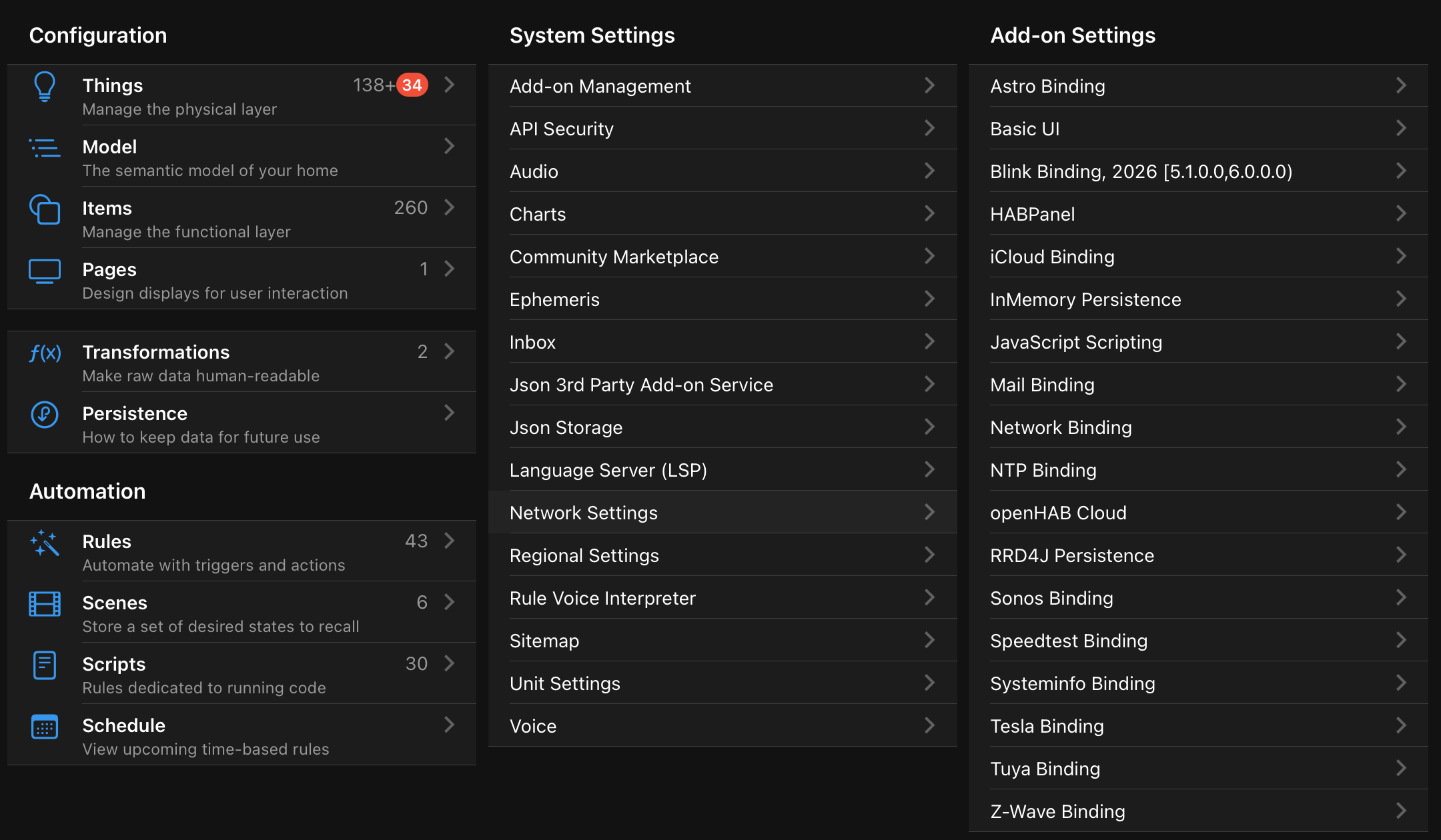

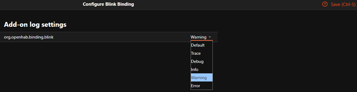

You can also set trace and other logging settings via the UI.
Settings → Add-on Settings → select add-on → select log setting → Save

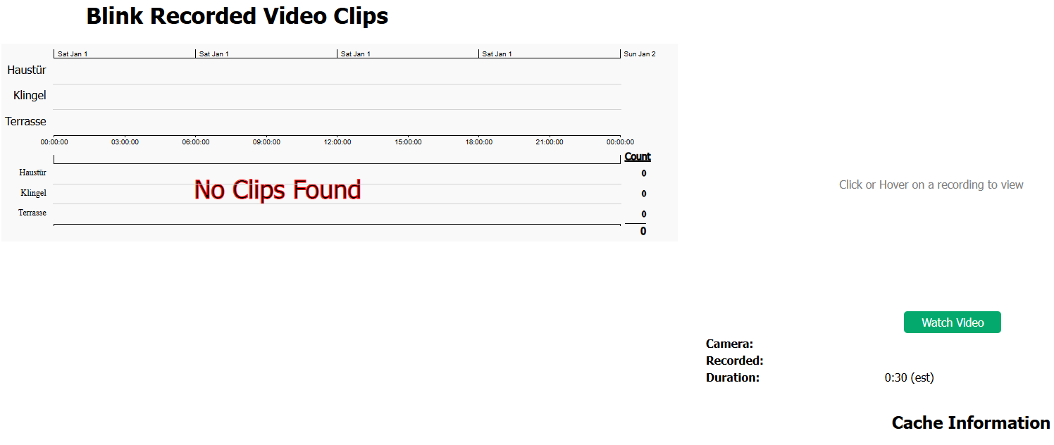

yikes, it doesn’t even show any recordings/clips. hmmm. Do you have an older sync module with a USB-A port on it? (I’m guessing so since you said your cameras are gen3). I wonder if there’s a way for me to use local storage even though I have a “subscription”. I clearly need to build in more TRACE statements to see what’s being returned from the API calls. There aren’t any exceptions that I see in your output, but also no evidence that the call worked either.
I didn’t know you could set the log levels through the UI, lol, thanks!!

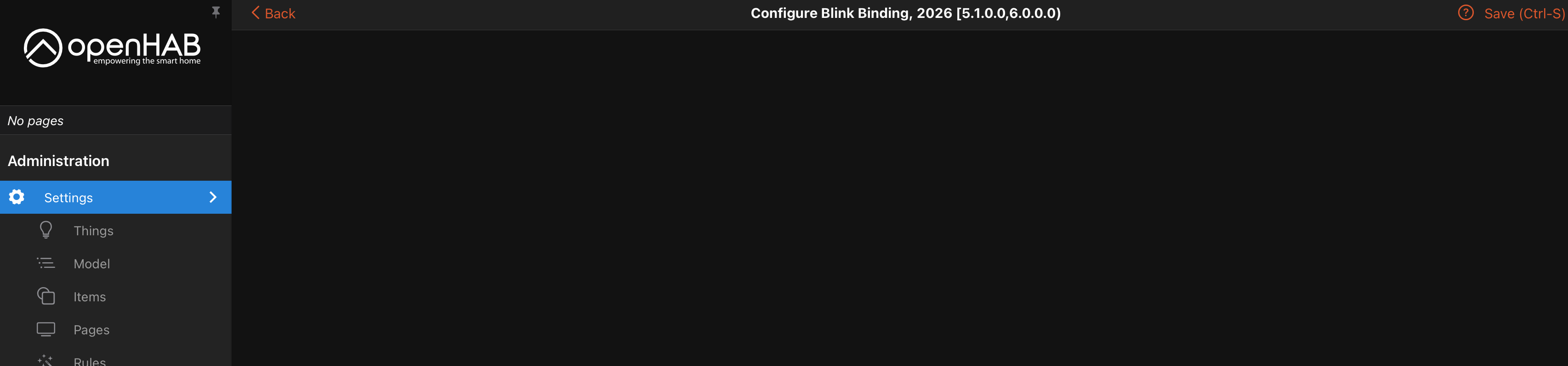

@Moriarty hmmm, when I go to
Settings → Add-On Settings → select the Blink Binding →
The page is blank (there’s a Save and Back button but nothing to configure). Is there a master setting which would globally enable the selection of log levels graphically for each add on?
I also notice your title is different from mine (Configure Blink Binding, 2026 [5.1.0.0,6.0.0.0))

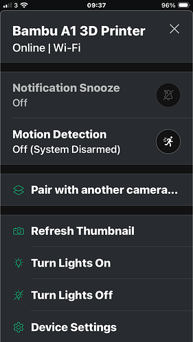

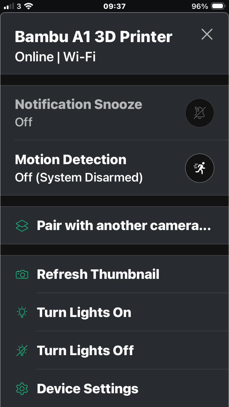

The LED is a white LED on the front of the camera, I think supposed to be a room illuminator but I’m not sure how good it would be for that, but I use the camera to monitor my 3D Printer and the illumination is perfect for that :slight_smile:
In the App, clicking on the of the thumbnail of the camera brings you directly to this menu:
Weird menu (I Know) as the ‘Turn Lights On’ and ‘Turn Lights Off’ menus are both displayed all the time, no matter what the status of the light is (and for some reason the menu shows the plural ‘lights’, but this might be something to do with the ‘Pair’ option - but I only have one of these cameras).
Hope this helps.
huh! I’ve never seen those buttons and never heard of a “hawk” type of camera. Is the camera visible on the commercial Cameras and Systems — Blink Smart Security website as a current product?
Is there any way you could determine what URL is accessed when you press Turn Lights On (or Off)?
I wonder what the Pair with another camera button does. Is that the android app? I wonder how the pan/tilt products are controlled too. Yikes I have a lot of learning to do!

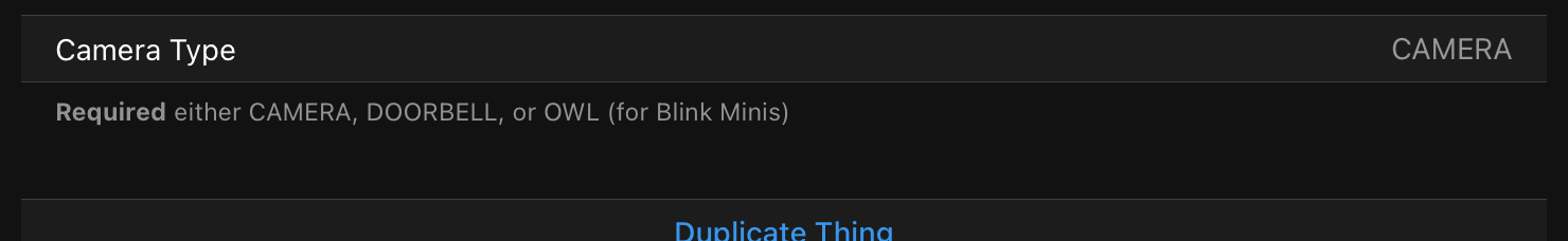

The code has a big if / else block which translates the blink code names (e.g. sedona) to the retail camera model (e.g. “gen 4”). I’ll add a block for hawk to be translated as “mini 2”. Thanks!

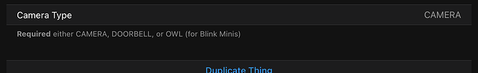

Also curious about the hawk / mini2. In the Camera Thing, in the CONFIGURATION section (not properties), does it show as a CAMERA or an OWL?
OWLs (mini gen 1) do not report:
  1. camera temperature
  2. battery level (they are USB powered)
  3. battery voltage
  4. WIFI level / RSSI
  5. sync module level / RSSI (they don’t need sync modules)
I’d eventually like to determine for sure whether the mini 2 / hawk also doesn’t support those items. We can come back to that!
It shows as OWL
