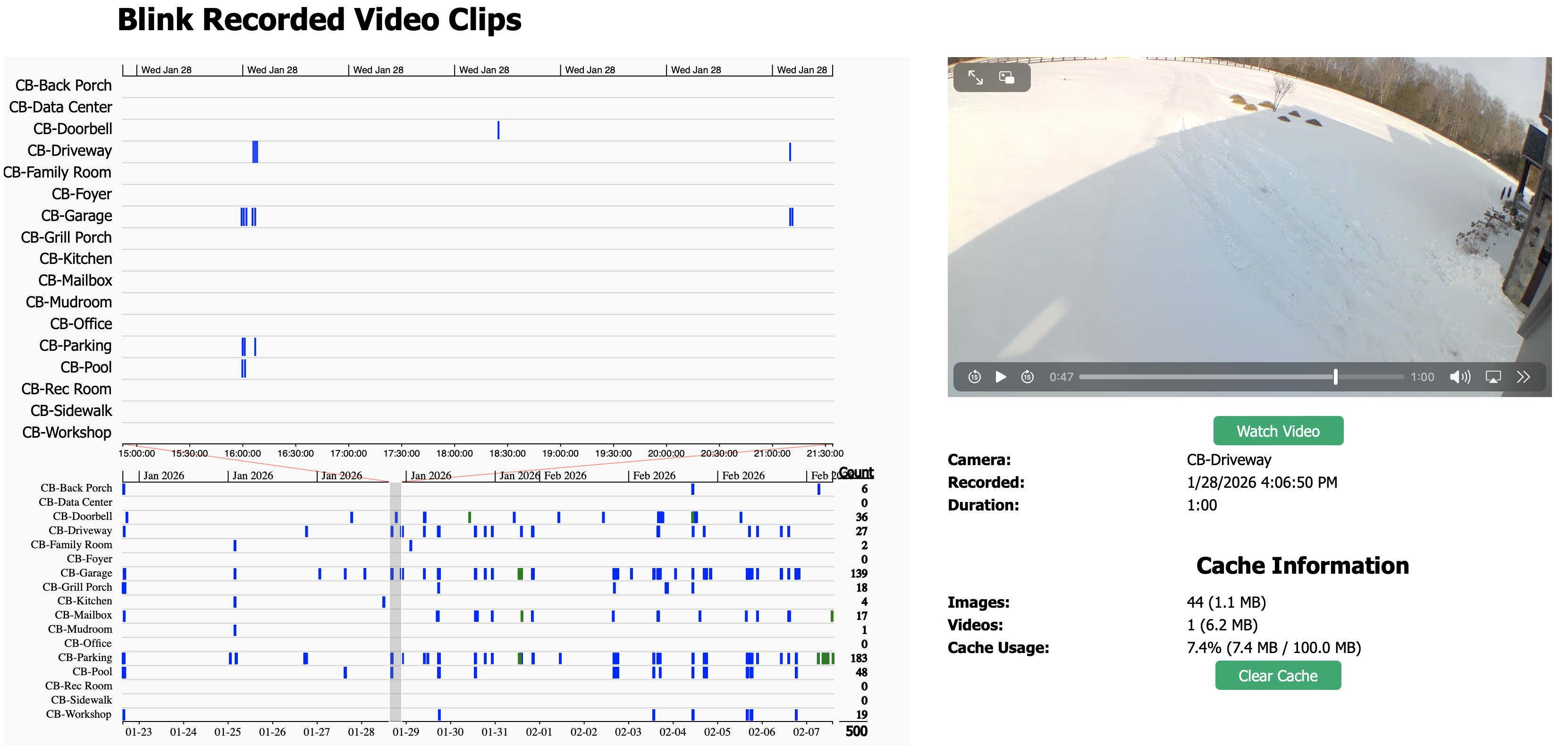

  • Implemented Blink Recorded Clips web page: a swimlane viewer for thumbnails & videos (see screenshot below)

Screenshot of built-in Recorded Videos web page:
screenshot

All, I published a new update, v5.2.0.202602072213. It contains the video playback web page, please check it out and send feedback. (Updated post at the top of this thread).

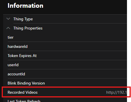

The version number is shown in the Blink Account thing’s Properties, along with the URL to your web page viewer.

I am confused, though, how I should access the web page for the swim lane video playback.
Please look at the bridge in the UI and click on Thing Properties.
