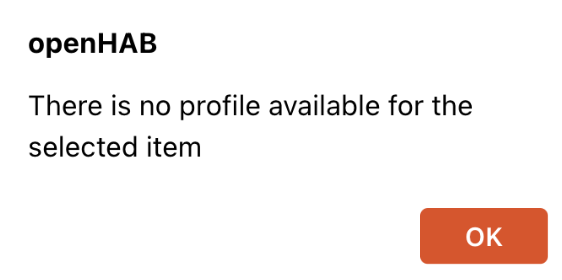

Hi, is there any update regarding the missing profile issue? Whenever I want to link the channel to an item there is no profile available. So I can’t use this very useful channel :frowning:
Thanks in advance!

@doktormo, do you have a chance to look into the issue (greyed out profile options for Motion Trigger channel) I’m seeing? Do you need any further details?
Thanks in advance!
