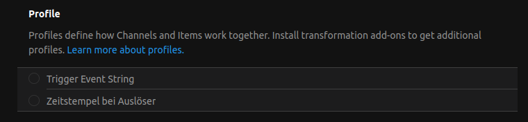

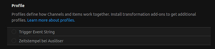

Hi all. First of all thank you so much Matthias for this great Binding.
I have one question: How I can add the Motion triggered channel of my Blink camera? I use OpenHab 3 and add channels over the things UI of OpenHab. When I select the “Motion triggered” channel of my camera for linking channel to Item, I have the problem that OpenHab don´t offer me any Profiles to it. How would be the correct workflow here?
Thanks,
Adam
I have exactly the same issue here. Can’t add Motion Trigger cause there is no option for profile. Both options greyed out.
