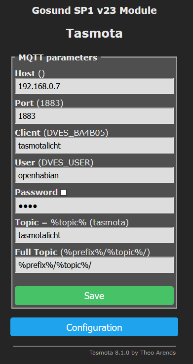

Tasmota mqtt settings

Looking at your files I would expect the stateTopics to read something like:
stat/tasmotalicht/POWER and the commandTopic: cmd/tasmotalicht/POWER that’s for the first channel, the following change the same way.

Important:
Working with
[ stateTopic="stat/tasmotalicht/POWER", commandTopic="cmnd/tasmotalicht/POWER" ]
not working with
[ stateTopic="tasmota/tasmotalicht/stat/POWER", commandTopic="tasmota/tasmotalicht/cmnd/POWER", on="ON", off="OFF" ]
