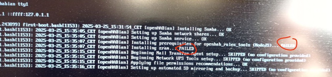

I can’t install OpenHab on Rasberry using standard tools because the installation source is blocked (I’m in Russia). Manual installation goes badly and then doesn’t work.
How to solve the problem of standard installation?

I managed to install OH 4.3.3 via VPN. I write the image to the card. After it deploys, I install VPN on the Raspberry. I launch it.
Then I install this https://pkgs.tailscale.com/stable/#raspbian-bookworm
Then this - sudo apt install openresolv
Then from openhabian-config, mosquito and z2m are installed. Under VPN, z2m installed without errors. Manual installation does not lead to a working version. Because it causes a version conflict within the system. And it is not possible to select versions manually.
