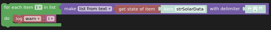

I have been trying to use Blockly to split this string at the comma. Below is my first attempt:
Code
var i;
var i_list = itemRegistry.getItem('strSolarData').getState().split(',');
for (var i_index in i_list) {
  i = i_list[i_index];
  logger.warn(i);
Unfortunately, I get the following error in the log when clicking Run Now:
[ERROR] [.internal.handler.ScriptActionHandler] - Script execution of rule with UID '6caf048c18' failed: TypeError: (itemRegistry.getItem("strSolarData").getState()).split is not a function in <eval> at line number 6

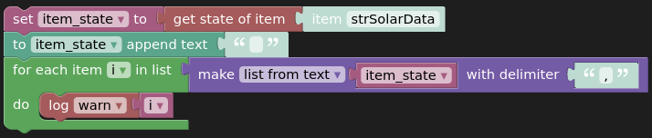

OK, so there’s a TypeError. Strange, because it’s a String Item, and I’m trying to perform a function (split) which is usually performed on Strings. Maybe the get state of item block isn’t returning a String? To test this, I modified the code to force the variable to store itself as a String by deliberately appending “”:
Code
var item_state, i;
item_state = itemRegistry.getItem('strSolarData').getState();
item_state += '';
var i_list = item_state.split(',');
  logger.warn(i);
Success! I get the following in the log:
15:47:31.970 [WARN ] [org.openhab.rule.6caf048c18          ] - {2021-12-29=569
15:47:31.992 [WARN ] [org.openhab.rule.6caf048c18          ] -  2021-12-30=469}

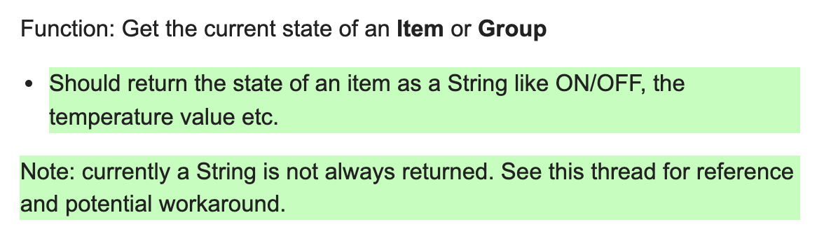

According to the current reference documentation the get state of item block should be returning a String.
returns the state of an item as a String like ON/OFF, the temperature value etc.
but that doesn’t seem to be the case for me.

yeah T, I think Stefan has been furiously attempting to document the known issues in the reference thread but the reference thread is a wiki so anyone can add to or edit the thread.
I’ve made a small edit to the relevant section which should help others hitting the same issue for now.
excellent! :+1:
We need all the help we can get
Thanks for trying :slight_smile: but it is even a bit more complex:
It doesn’t say that it returns a String but a State. Even though a state most often is a String it doesn’t necessarily need to be one. I am not sure in your case what kind of State is returned and why it is not a String.
see openHAB-State
I would re-rewrite and make a note as above, agreed?
To be clear, this was the original bullet point in the documentation:
So the documentation said that get state of item returns the state of an Item as a String. To the end user, they would expect a string.
I added the word Should in front of that sentence, and then the Note below that bullet point to help new users workaround the issue.
For an end-user this isn’t helpful so I wouldn’t add that to the documentation at the moment - especially as using this function on a String Item doesn’t seem to be returning a String.
True, fair enough, but I don’t like the work “should” in a documentation because it basically says it should but sometimes it doesn’t which sounds you cannot trust it. We should (:wink: ) rather find something that is clear and correct. I wouldn’t also like to reference a thread but make the reference the core documentation to point at.
which is why I linked to the State-documentation. Basically when user work work with complex states there is eventually no way of understanding their complexity. I think there is no easy way to hide that with blocks.
I really appreciate your effort and I am not arguing - I am just looking for a clear and concise wording for the reference (which I am currently working at).
Which is true right now, isn’t it?
Is my use-case working with a complex state?
Agreed, but we should document what the user should expect to see, not say
because that won’t mean anything to most users. Linking to the state-documentation also isn’t helpful for most users. It means nothing to me, and I don’t know how it would have helped solve my issue.
