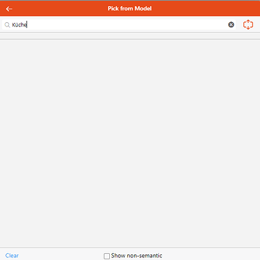

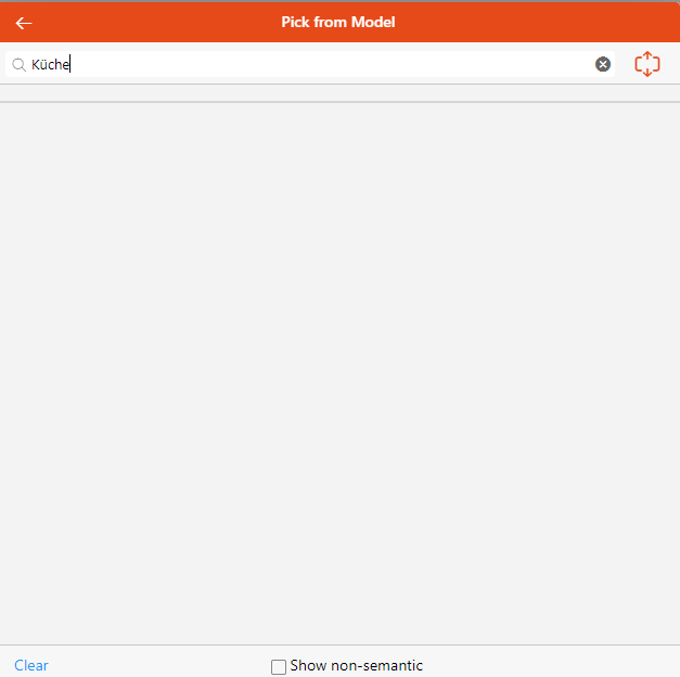

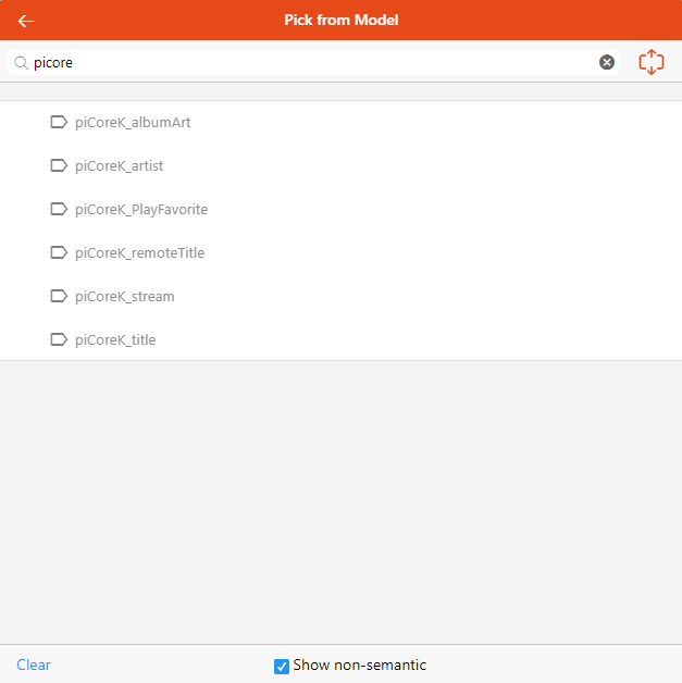

but i can’t find/pick the items which are members of group piCoreK (showing also non-semantic):
and not showing non-semantic:
what exactly am i missing? :confused:
thanks for any help!

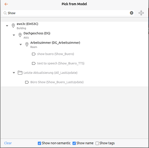

Is still(/again?) have this issue. Some items do not show up in the picker, only when I have ticked “show non-semantic” AND “show name” and have them in a defined group (order):
Player Show_Buero                           "show buero"        <amazon_display>    (DG_Arbeitszimmer, Alexa_Buero, All_Echo, gAlexa)   ["tTTS"]  {channel="amazonechocontrol:echoshow:account1:show_buero:player"}
String Show_Buero_MusicProviderId           "music provider"    (Alexa_Buero, All_Echo_MusicProviderId)     {channel="amazonechocontrol:echoshow:account1:show_buero:musicProviderId"}
String Show_Buero_PlayMusicCommand          "play music"        (Alexa_Buero, All_Echo_PlayMusicCommand)    {channel="amazonechocontrol:echoshow:account1:show_buero:playMusicVoiceCommand"}
Dimmer Show_Buero_Volume                    "Volume"            (Alexa_Buero, All_Echo_Volume)              {channel="amazonechocontrol:echoshow:account1:show_buero:volume"}
Dimmer Show_Buero_TTS_Volume                "tts Volume"        (Alexa_Buero, All_Echo_TTS_Volume)  ["tTTSVolume"]  {channel="amazonechocontrol:echoshow:account1:show_buero:textToSpeechVolume"}
String Show_Buero_TTS                       "text to speech"    (DG_Arbeitszimmer, Alexa_Buero, All_Echo_TTS) ["tTTS"]    {channel="amazonechocontrol:echoshow:account1:show_buero:textToSpeech"}
When I search for “show” in the picker, I will get the items “Show_Buero” and “Show_Buero_TTS” because they are in the DG_Arbeitsplatz group. This group in nested into several items:
Group           EWS3C                       "ews3c"                 <house>                                             ["Building"]
Group           DG                          "Dachgeschoss"          <attic>             (EWS3C)                         ["Attic"]
Group           DG_Arbeitszimmer            "Arbeitszimmer"         <coding>            (EWS3C, DG)                     ["Room"]
I am running OH 4.2.2. Is this the same issue or do I miss something else?

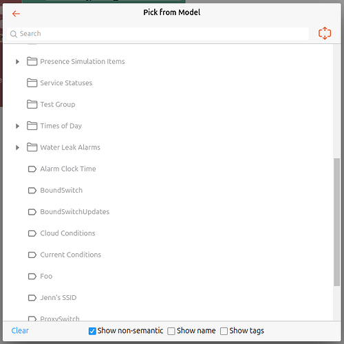

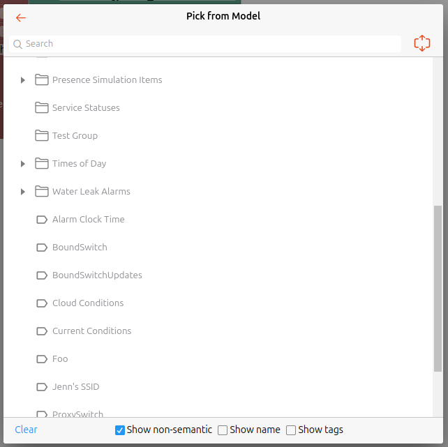

I’m not seeing this. When I check “show non-semantic” I see all my Items whether they are in a Group or not.
Are you looking in the right spot? First are the semantically tagged Items, then the Groups and only then the Items that are not in Groups.
Have you looked in the Alexa_Buero Group or one of the All_Echo Groups in the list? The Item will only appear in one place in the list and I’m not sure how which Group it appears in is chosen.

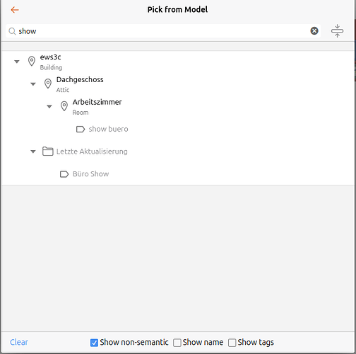

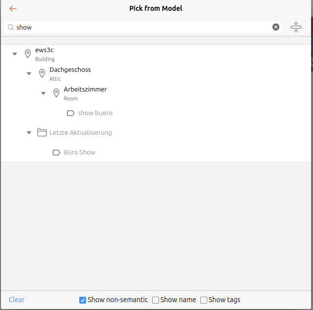

Show non-semantic (i did tick the pox and searched afterwards)
Show name:
I understand why both are different (for the TTS item “show” is only in the item name), but when I search for “text”, several other items should show up but the are nowhere to be found.

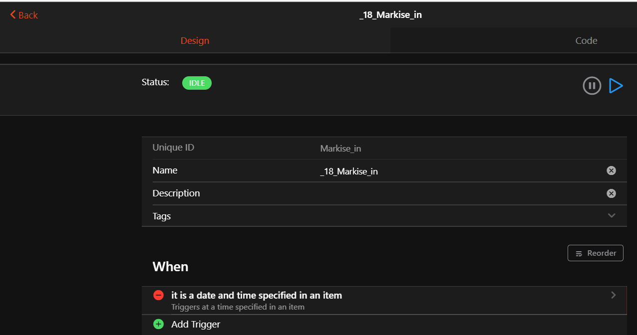

Edit: just realized I have this issue elsewhere too:
When I use “add trigger” in a rule and select “item” I will get the same picker and will not get a list of all items. With “show all” → “item stage is updated” I get a different type of list which provides all items:

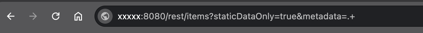

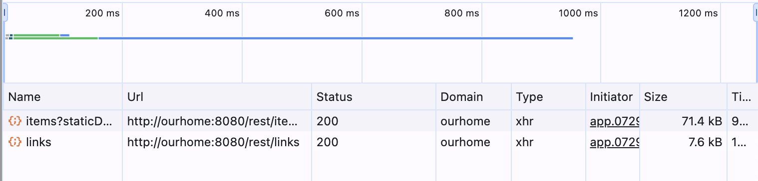

  • Please create a blockly rule and add the following block
  • Then in the browser open the developer tools (on mac cmd-option-i)
  • select the network tab
  • only now click on “myitem” to open the selection dialog
  • It should give you an entry in the network tab like so
  • Copy the URL like below
  • Open a new browser tab and paste the URL
and you should get a result.
  • Check within the result of the item in question is contained.
  • repeat with the following checkbox selected
