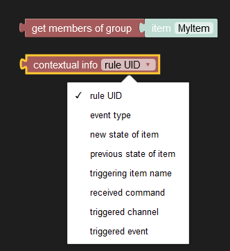

Yes, the group members part is in Items & Things and is ‘get members of group’ which you can then run the rule from
The other part is in ‘Run & Process’ called contextual info and you can use this to grab lots of useful things, including the received command, or state of item etc

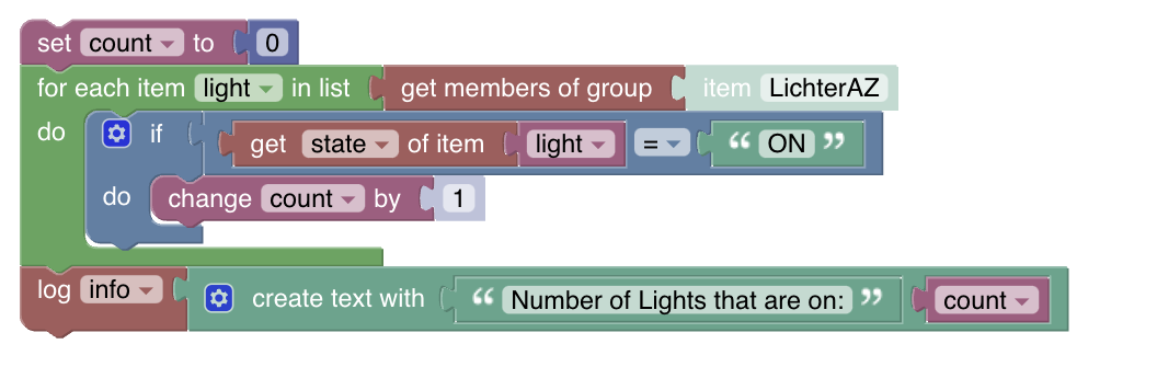

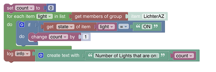

I am not totally sure what you meant to achieve :thinking: but if the intent is to count how many of the group’s members are OPEN then you could use this approach (I am here counting the number of lights that are on as it was either to test it out)
Hi Stefan
Thanks for your reply.
Yes, thats exactly what i was looking for and the longer i look at your block assembly, the more obvious it becomes.
Lesson learned !
Thanks a lot
