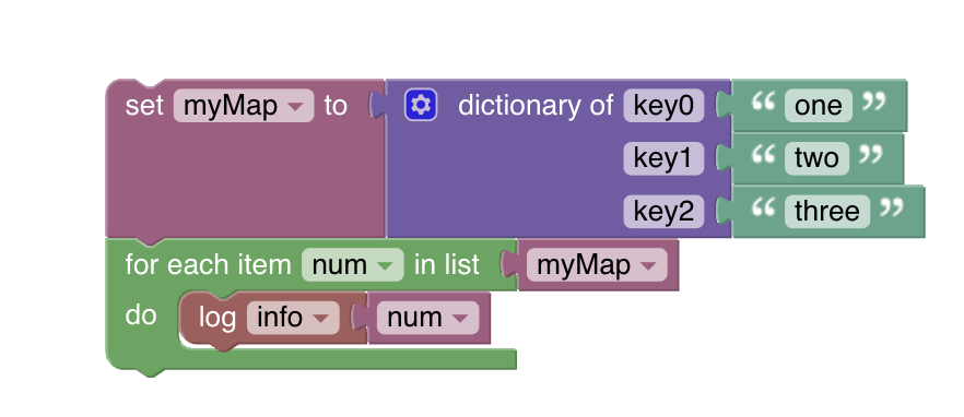

This works for me
Is this what you intend to do?
Ok. I guess num represents the value and not the key. Is it also possible to access the key with this apporach? I need the key and the value in the loop.

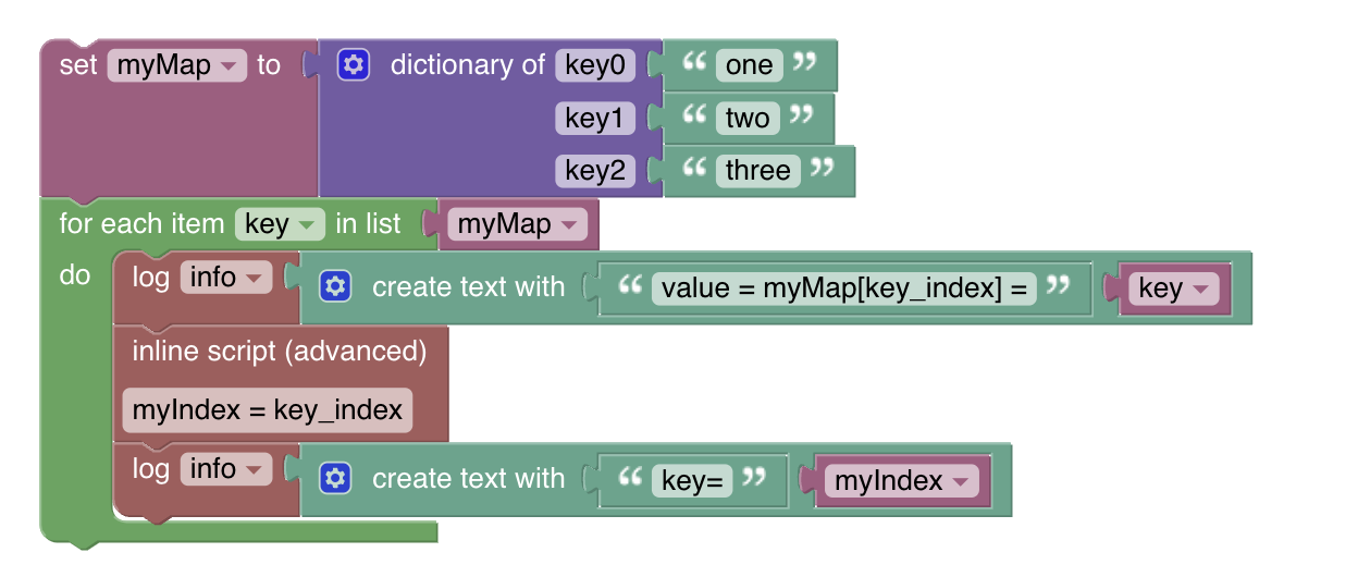

Let’s rename the variable to key and magically the block will create a code that generates a key and a key_index variable
and this code
myMap = {'key0': 'one', 'key1': 'two', 'key2': 'three'};
for (var key_index in myMap) {
  key = myMap[key_index];
  logger.info(('myMap[key_index] =' + String(key)));
So the key(index) is actually there but you just can’t access it via a block, right?

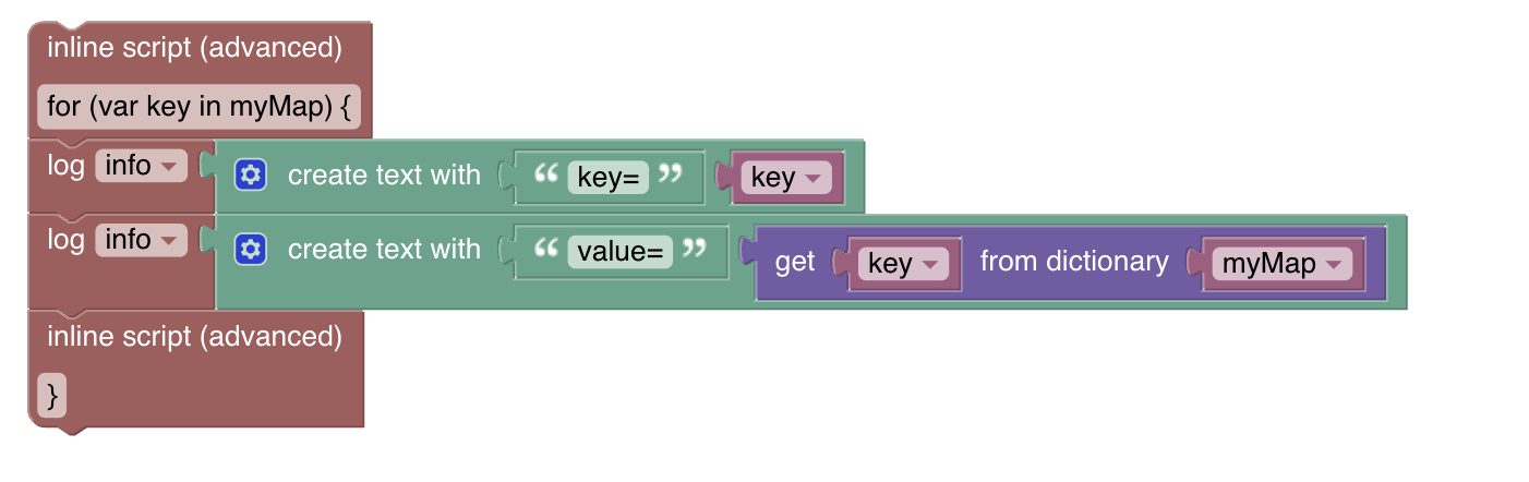

well, there is a way of doing it with a trick:
  • define a variable myIndex
  • use a script block to assign the variable key_index to it.
Of course, this is only possible because we know the insights of the block code generation:

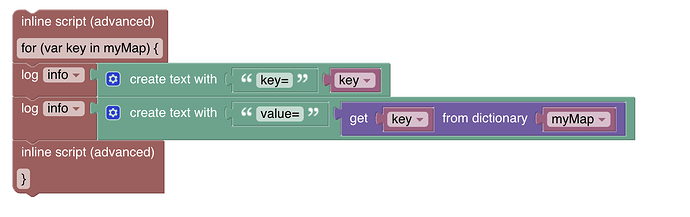

… but it does work. For the sake of completeness there is even another less elegant version where we create our own loop :wink: … I leave to the reader to find out why that one works (have a look into the generated code :wink: )
