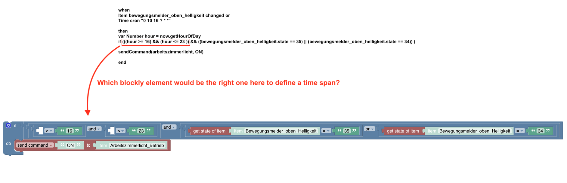

Which Blockly element would be the right one in OH3 to define a time span (see screenshot)?

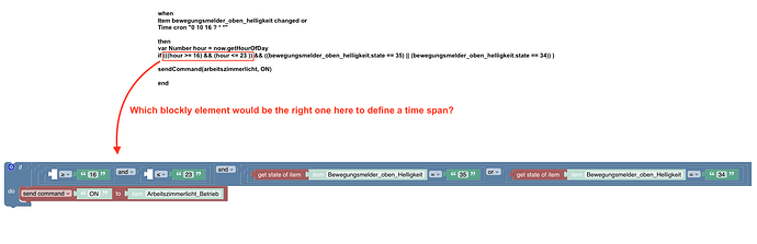

It could look like this with some slight changes.
You dont need the cron trigger because you check in the if statement if it’s after 16:00
and your illuminance should be a non equal because your rule triggers only when the state is 35 or 34.
When Item bewegungsmelder_oben_helligkeit changed
and the value is below 36
and the time is after 16:00
and the time is before 23:00
the command will be sent
