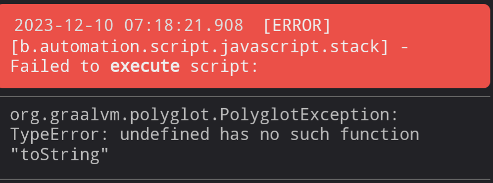

In OH4 some blocks of contextual info (command, newState, oldState) now have a toString already included.
While this is mostly useful it causes a rule to fail with type-errors if the specific contextual info is undefined.
The (I think pretty common) use case is when a rule has different triggers like commands, changeEvents.

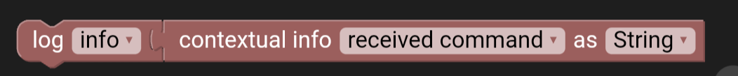

I guess this question mainly goes to the marvelous @stefan.hoehn (who put a lot of work to turn blockly in such a great tool for openhab ): Would it be possible to change the contextual blocks so that they donât fail if evaluated to undefined?
It can be reproduced by a rule with only a contextual block which is triggered manually:

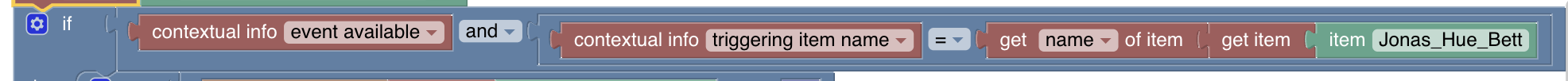

yes, I know that one.
But it doesnât help if a rule is triggered by change and command events because event available is true in both cases.
So I didnât find a clean solution to evaluate the command and newState values.

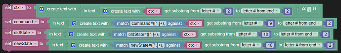

My current workaround is to directly search within the ctx-context.
