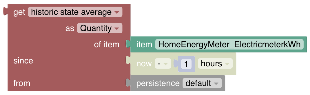

Hmmm. I’m on OH 4.3 M1 and I think there have even been some changes between 4.2.1 and 4.3 M1. I’m seeing an extra flag in the block:
The code generated has some important differences too:
items.getItem('HomeEnergyMeter_ElectricmeterkWh').persistence.averageSince(time.ZonedDateTime.now().minusHours(1))?.quantityState;
