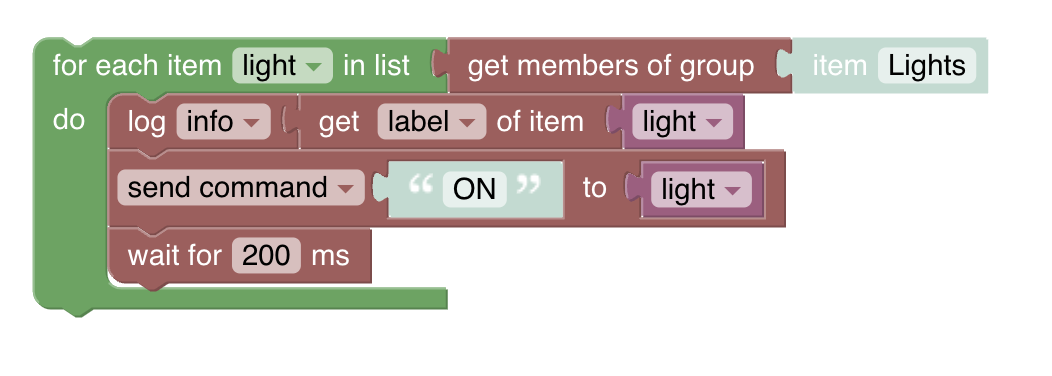

Now I wonder how I can migrate the following code to a Blockly function:
I have assigned a few (KNX) motion detectors in my home which have a red blinking LED, that can be turned on and off, into a (classic) group. I learned that in the “old DSL” I should use this following code block to efficiently turn on all the red lights:
(The 200 ms delay is to make it work. The binding or something “behind” it seemed to have had an issue to send out all telegrams in case there was no delay.)
Bewegung_LED_Rot.allMembers.forEach[item |
logInfo("Red LED Switch", "item: " + item.label.toString() + " switch red LED ON" )
sendCommand(item, ON)
Thread::sleep(200)
FYI - this is the definition of
Group Bewegung_LED_Rot "Bewegung LED Rot" <present>
and then the individual Red LEDs are normal switch items.
I could not find any Group Block in my Blockly list and also did not see something like a “forEach” in the “Loops” section.
Thanks for any advice on this.
