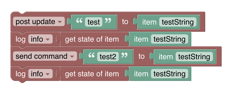

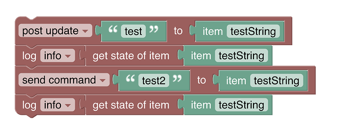

Yes, you have to post an update not send a command. A command “indirectly” updates an item, a post does it directly.
postUpdate is used to update the state of an item without triggering any associated bindings or sending commands to the device or service it represents.
sendCommand is used to send a command to an item, and it often results in a change in the state of the item.
which is not related to blockly.
However, please read the blockly docs that link to the respective docs that explain the differences:
and therefore
