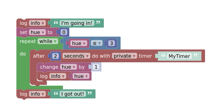

My timer loops that used to work in 3.4 get stuck in infinite loops in 4.0. Is this intentional, or is it a bug?
The script above used to work in 3.4, but does no more, now it ends up in an infinite loop.

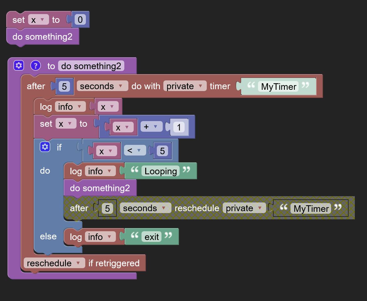

To test, I wrote the script below. It never exits.
Is the problem in my code or is this a bug?
Some questions and a proposal:

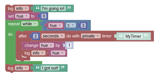

Why do you do a repeat loop around a timer??? What is the intent here?
This creates the same time three times which may have unexpected results.
Can we simplify the topic and just create the one timer only and remove the repeat loop?
What code is it creating?

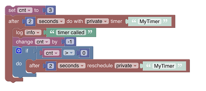

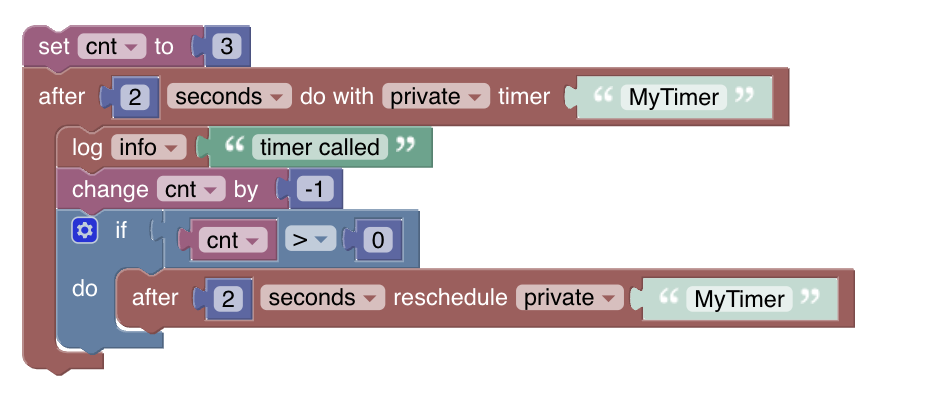

Do you want the timer to run only three times and then stop? Because then the right way to do it is as follows:
Update note: As mentioned by Rich, there is a small mistake in the above image as it needs to be âcnt >=0â. Sorry for the confusion.

I tried this, the loop executes 2 times and exits regardless of the value of cnt.
Can you confirm this behavior?
Thereâs an off by one error in @stefan.hoehnâs code. It should be âif cnt >= 0â. With just > the timer will only reschedule itself twice instead of three times.
30 years of programming and I still donât get loops right
