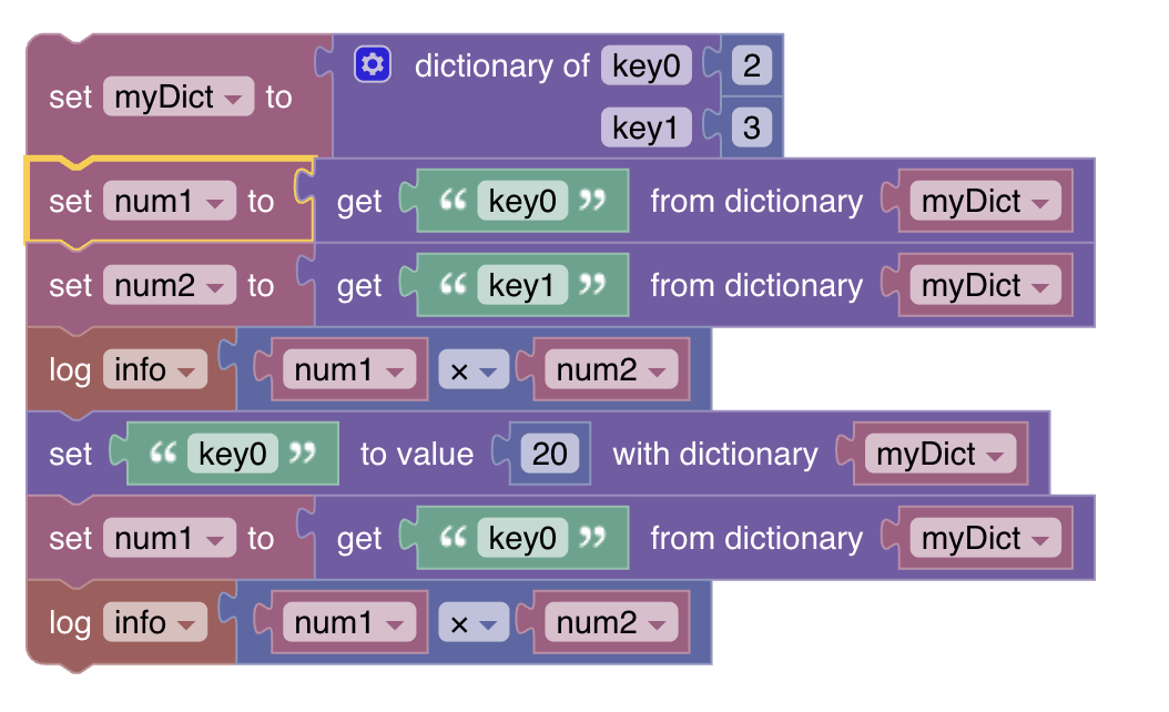

This works for me.
The first log says 6 and the second says 60
 [INFO ] [omation.jsscripting.rule.1_test_dict] - 6
 [INFO ] [omation.jsscripting.rule.1_test_dict] - 60
