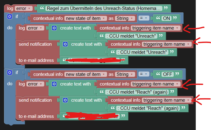

There have been several new blocks in Blockly for contextual info (e.g. the name of the triggering item, which is and works fantastic!). I use this block to let me know which of my HomematicIP-devices have gone offline (they each have a switch called “unreach” which the Gateway sets to “ON” if the device can’t be reached anymore).
My rule works perfectly with those two blocks…

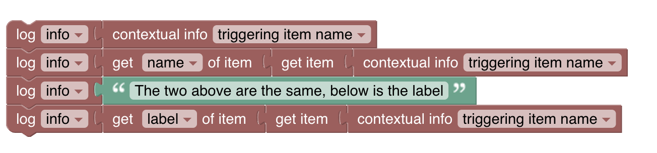

… except that I can (via the block image) only access the name of the item, not the name of the triggering item. It’s not that big of a deal, but the label of an item typially looks much nicer than the rather cryptic name of an item.
Is this possible?

Is this what you are looking for?
…now I feel a bit embarrased. Thanks! :slight_smile:
