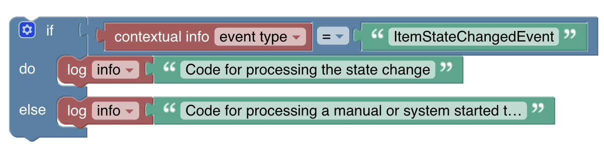

In both of these cases, the rule needs to do something different based on how it’s triggered so it’s best to test the trigger to see what to do than it is to set the command to something that avoids an immediate error (“undefined”) but can result in errors later on or worse, no errors but incorrect behavior.

Though testing event.type would be the proper way to handle that latter use case.

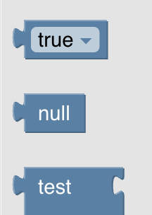

There is a block for null already.
So today it’s possible to test for null but not undefined.
You can use if else blocks though. That’s what I meant.

Do we have the conclusion adding an undefined-block and that would be it?
That would be my preference as it has applications outside this specific use case. It should be super simple to implement but I don’t know if you can add it to “Logic” or if it’ll have to be under one of the openHAB categories. Since null is under “Logic”, that seems like the appropriate place for it but I don’t if there are technical or policy reasons to prevent that.
Another alternative would be somehow to make the null block cover both null and undefined but I don’t think that’s technically feasible while keeping the null block working like it does now.
Yet another alternative would be adding something like an “exists” block that tests for both undefined and null. Though this block would only really be useful with the two context blocks I think but that’s probably fine.
Any of these make sense to me.

Yes it is possible to add the block. everything else would not be nice.
Update: it was even easier than I thought…
https://github.com/openhab/openhab-webui/pull/2465
@Larsen PR is merged :wink:

if(event.newState == undefined) {
  // do what needs to be done when it's undefined
else {
    // do what needs to be done when it is defined
If you have to test anyway, why not test for undefined or test event.type?
